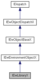

Inheritance diagram for IEwLibraryX:
Inheritance graph
