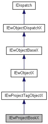

IEwProjectBookX Interface Reference
Use this interface to manage book inside a project. More...
Inheritance diagram for IEwProjectBookX:
Inheritance graph
