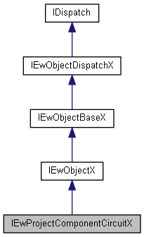

IEwProjectComponentCircuitX Interface Reference
Use this interface to manage component element inside a project. More...
Inheritance diagram for IEwProjectComponentCircuitX:
Inheritance graph
