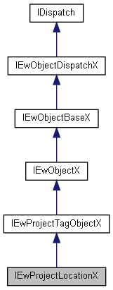

Inheritance diagram for IEwProjectLocationX:
Inheritance graph
