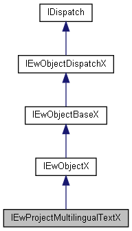

Inheritance diagram for IEwProjectMultilingualTextX:
Inheritance graph
