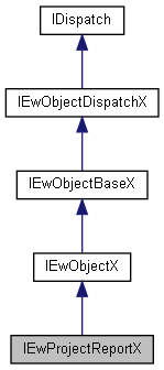

Inheritance diagram for IEwProjectReportX:
Inheritance graph
