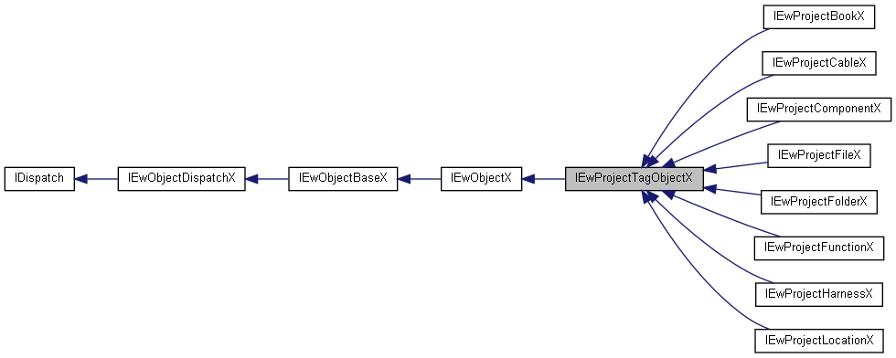

IEwProjectTagObjectX Interface Reference
Generic interface for an object that belongs to a project. More...
Inheritance diagram for IEwProjectTagObjectX:
Inheritance graph
