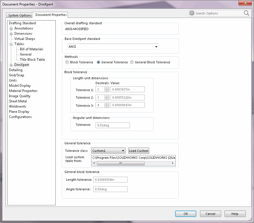

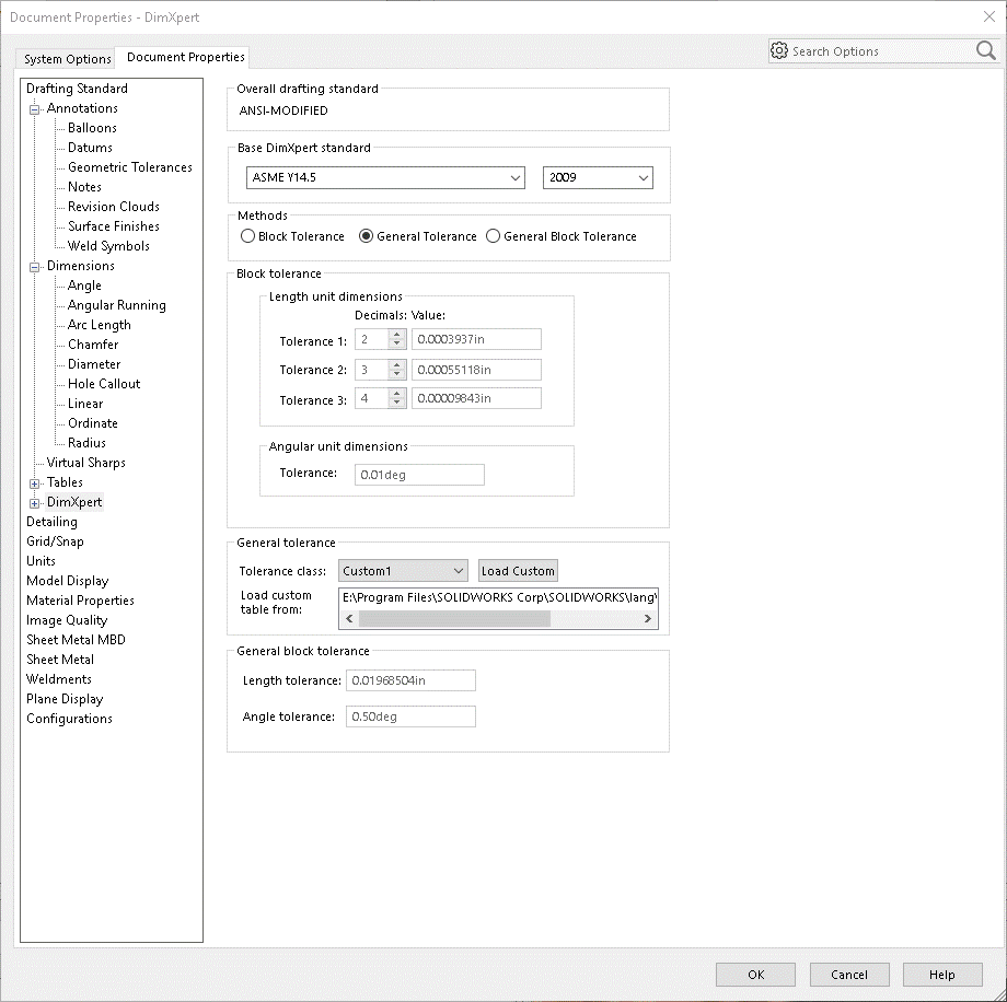

Document Properties > DimXpert
Setting
Get/Set Methods
Return Value
or
<Value>
or
<OnFlag>
Comments
Methods - Block Tolerance or General Tolerance
IModelDocExtension::GetUserPreferenceToggle(swUserPreferenceToggle_e.swPartDimXpertBlockTolerance swUserPreferenceOption_e.swDetailingNoOptionSpecified)
IModelDocExtension::SetUserPreferenceToggle(swUserPreferenceToggle_e.swPartDimXpertBlockTolerance, swUserPreferenceOption_e.swDetailingNoOptionSpecified, <OnFlag>)
Boolean value
Specifies whether to use Block Tolerances or General Tolerances on dimensions that do not contain tolerances; true for Block Tolerances
Block Tolerance - Length unit dimensions - Tolerance 1 - Decimals
IModelDocExtension::GetUserPreferenceInteger(swUserPreferenceIntegerValue_e.swPartDimXpertLengthUnitTol1Decimals, swUserPreferenceOption_e.swDetailingNoOptionSpecified)
IModelDocExtension::SetUserPreferenceInteger(swUserPreferenceIntegerValue_e.swPartDimXpertLengthUnitTol1Decimals, swUserPreferenceOption_e.swDetailingNoOptionSpecified, <Value>)
Integer value
Specifies number of decimal places for first tolerance
Block Tolerance - Length unit dimensions - Tolerance 1 - Value
IModelDocExtension::GetUserPreferenceDouble(swUserPreferenceDoubleValue_e.swPartDimXpertLengthUnitTol1Value, swUserPreferenceOption_e.swDetailingNoOptionSpecified)
IModelDocExtension::SetUserPreferenceDouble(swUserPreferenceDoubleValue_e.swPartDimXpertLengthUnitTol1Value, swUserPreferenceOption_e.swDetailingNoOptionSpecified, <Value>)
Double value in meters
Specifies symmetric plus or minus tolerance for first tolerance
Block Tolerance - Length unit dimensions - Tolerance 2 - Decimals
IModelDocExtension::GetUserPreferenceInteger(swUserPreferenceIntegerValue_e.swPartDimXpertLengthUnitTol2Decimals, swUserPreferenceOption_e.swDetailingNoOptionSpecified)
IModelDocExtension::SetUserPreferenceInteger(swUserPreferenceIntegerValue_e.swPartDimXpertLengthUnitTol2Decimals, swUserPreferenceOption_e.swDetailingNoOptionSpecified, <Value>)
Integer value
Specifies number of decimal places for second tolerance
Block Tolerance - Length unit dimensions - Tolerance 2 - Value
ModelDocExtension::GetUserPreferenceDouble(swUserPreferenceDoubleValue_e.swPartDimXpertLengthUnitTol2Value, swUserPreferenceOption_e.swDetailingNoOptionSpecified)
IModelDocExtension::SetUserPreferenceDouble(swUserPreferenceDoubleValue_e.swPartDimXpertLengthUnitTol2Value, swUserPreferenceOption_e.swDetailingNoOptionSpecified, <Value>)
Specifies symmetric plus or minus tolerance for second tolerance
Block Tolerance - Length unit dimensions - Tolerance 3 - Decimals
IModelDocExtension::GetUserPreferenceInteger(swUserPreferenceIntegerValue_e.swPartDimXpertLengthUnitTol3Decimals, swUserPreferenceOption_e.swDetailingNoOptionSpecified)
IModelDocExtension::SetUserPreferenceInteger(swUserPreferenceIntegerValue_e.swPartDimXpertLengthUnitTol3Decimals, swUserPreferenceOption_e.swDetailingNoOptionSpecified, <Value>)
Integer value
Specifies number of decimal places for third tolerance
Block Tolerance - Length unit dimensions - Tolerance 3 - Value
ModelDocExtension::GetUserPreferenceDouble(swUserPreferenceDoubleValue_e.swPartDimXpertLengthUnitTol3Value, swUserPreferenceOption_e.swDetailingNoOptionSpecified)
IModelDocExtension::SetUserPreferenceDouble(swUserPreferenceDoubleValue_e.swPartDimXpertLengthUnitTol3Value, swUserPreferenceOption_e.swDetailingNoOptionSpecified, <Value>)
Specifies symmetric plus or minus tolerance for third tolerance
Angular unit dimensions - Tolerance
ModelDocExtension::GetUserPreferenceDouble(swUserPreferenceDoubleValue_e.swPartDimXpertAngularUnitTolValue, swUserPreferenceOption_e.swDetailingNoOptionSpecified)
IModelDocExtension::SetUserPreferenceDouble(swUserPreferenceDoubleValue_e.swPartDimXpertAngularUnitTolValue, swUserPreferenceOption_e.swDetailingNoOptionSpecified, <Value>)
Double value in radians
Specifies the tolerance value to use for all angular dimensions
General tolerance - Tolerance class
IModelDocExtension::GetUserPreferenceInteger(swUserPreferenceIntegerValue_e.swPartDimXpertGeneralToleranceClass, swUserPreferenceOption_e.swDetailingNoOptionSpecified)
IModelDocExtension::SetUserPreferenceInteger(swUserPreferenceIntegerValue_e.swPartDimXpertGeneralToleranceClass, swUserPreferenceOption_e.swDetailingNoOptionSpecified, swDimXpertGeneralTolClass_e.<Value>)
See swDimXpertGeneralTolClass_e for valid options
Specifies the part tolerance class
General tolerance - Load custom table from
IModelDocExtension::GetUserPreferenceString(swUserPreferenceStringValue_e.swLoadCustomTableFrom, swUserPreferenceOption_e.swDetailingNoOptionSpecified)
IModelDocExtension::SetUserPreferenceInteger(swUserPreferenceIntegerValue_e.swLoadCustomTableFrom, swUserPreferenceOption_e.swDetailingNoOptionSpecified, <Value>)
String value
Specifies the full path name of the custom table to load; non-empty value only for Parts and when Tolerance class is set to swDimXpertGeneralTolClass_Custom1 or swDimXpertGeneralTolClass_Custom2
