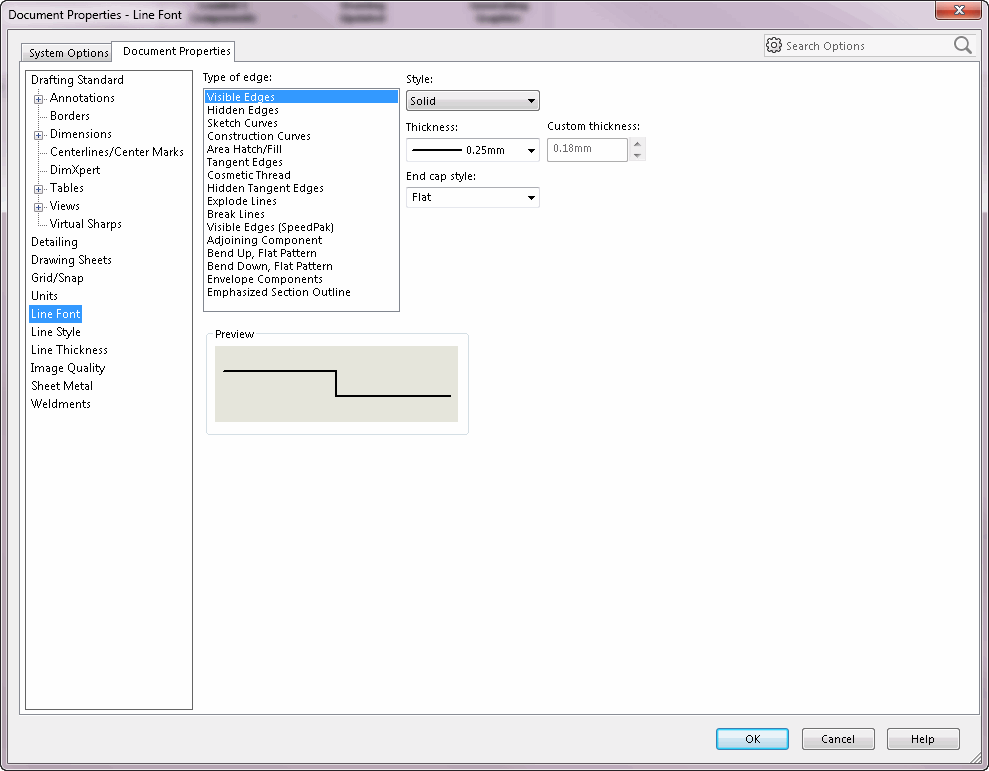

Document Properties > Line Font
Setting
Get/Set Methods
Return Value or <Value>
Comments
Visible Edges - Style
IModelDocExtension::GetUserPreferenceInteger(swUserPreferenceIntegerValue_e.swLineFontVisibleEdgesStyle, swUserPreferenceOption_e.swDetailingNoOptionSpecified)
IModelDocExtension::SetUserPreferenceInteger(swUserPreferenceIntegerValue_e.swLineFontVisibleEdgesStyle, swUserPreferenceOption_e.swDetailingNoOptionSpecified, swLineStyles_e.<Value>)
See swLineStyles_e for valid options except swLineDEFAULT
Specifies style of visible edges

Double value
Specifies a custom thickness for model edges in a SpeedPak drawing document
Adjoining Component - Style
ModelDocExtension::GetUserPreferenceInteger(swUserPreferenceIntegerValue_e.swLineFontAdjoiningComponentStyle, swUserPreferenceOption_e.swDetailingNoOptionSpecified)
IModelDocExtension::SetUserPreferenceInteger(swUserPreferenceIntegerValue_e.swLineFontAdjoiningComponentStyle, swUserPreferenceOption_e.swDetailingNoOptionSpecified, swLineStyles_e.<Value>)
Specifies style of the edges of adjoining components in drawing documents
Adjoining Component - Thickness
ModelDocExtension::GetUserPreferenceInteger(swUserPreferenceIntegerValue_e.swLineFontAdjoiningComponent, swUserPreferenceOption_e.swDetailingNoOptionSpecified)
IModelDocExtension::SetUserPreferenceInteger(swUserPreferenceIntegerValue_e.swLineFontAdjoiningComponent, swUserPreferenceOption_e.swDetailingNoOptionSpecified, swLineWeights_e.<Value>)
See swLineWeights_e for valid options
Specifies thickness of the edges of adjoining components in drawing documents
Adjoining Component - Custom thickness
IModelDocExtension::GetUserPreferenceDouble(swUserPreferenceDoubleValue_e.swLineFontAdjoiningComponentCustom, swUserPreferenceOption_e.swDetailingNoOptionSpecified)
IModelDocExtension::SetUserPreferenceDouble(swUserPreferenceDoubleValue_e.swLineFontAdjoiningComponentCustom, swUserPreferenceOption_e.swDetailingNoOptionSpecified, <Value>)
Double value
Specifies a custom thickness of the edges of adjoining components in drawing documents
Bend Up, Flat Pattern - Style
ModelDocExtension::GetUserPreferenceInteger(swUserPreferenceIntegerValue_e.swLineFontBendLineUpStyle, swUserPreferenceOption_e.swDetailingNoOptionSpecified)
IModelDocExtension::SetUserPreferenceInteger(swUserPreferenceIntegerValue_e.swLineFontBendLineUpStyle, swUserPreferenceOption_e.swDetailingNoOptionSpecified, swLineStyles_e.<Value>)
Specifies style of the bend lines indicating where to bend the sheet metal up in flat patterns in drawing documents
Bend Up, Flat Pattern - Thickness
ModelDocExtension::GetUserPreferenceInteger(swUserPreferenceIntegerValue_e.swLineFontBendLineUpThickness, swUserPreferenceOption_e.swDetailingNoOptionSpecified)
IModelDocExtension::SetUserPreferenceInteger(swUserPreferenceIntegerValue_e.swLineFontBendLineUpThickness, swUserPreferenceOption_e.swDetailingNoOptionSpecified, swLineWeights_e.<Value>)
Specifies thickness of the bend lines indicating where to bend the sheet metal up in flat patterns in drawing documents
Bend Up, Flat Pattern - Custom thickness
IModelDocExtension::GetUserPreferenceDouble(swUserPreferenceDoubleValue_e.swLineFontBendLineUpThicknessCustom, swUserPreferenceOption_e.swDetailingNoOptionSpecified)
IModelDocExtension::SetUserPreferenceDouble(swUserPreferenceDoubleValue_e.swLineFontBendLineUpThicknessCustom, swUserPreferenceOption_e.swDetailingNoOptionSpecified, <Value>)
Double value
Specifies a custom thickness of the bend lines indicating where to bend the sheet metal up in flat patterns in drawing documents
Bend Down, Flat Pattern - Style
ModelDocExtension::GetUserPreferenceInteger(swUserPreferenceIntegerValue_e.swLineFontBendLineDownStyle, swUserPreferenceOption_e.swDetailingNoOptionSpecified)
IModelDocExtension::SetUserPreferenceInteger(swUserPreferenceIntegerValue_e.swLineFontBendLineDownStyle, swUserPreferenceOption_e.swDetailingNoOptionSpecified, swLineStyles_e.<Value>)
Specifies style of the bend lines indicating where to bend the sheet metal down in flat patterns in drawing documents
Bend Down, Flat Pattern - Thickness
ModelDocExtension::GetUserPreferenceInteger(swUserPreferenceIntegerValue_e.swLineFontBendLineDownThickness, swUserPreferenceOption_e.swDetailingNoOptionSpecified)
IModelDocExtension::SetUserPreferenceInteger(swUserPreferenceIntegerValue_e.swLineFontBendLineDownThickness, swUserPreferenceOption_e.swDetailingNoOptionSpecified, swLineWeights_e.<Value>)
Specifies thickness of the bend lines indicating where to bend the sheet metal down in flat patterns in drawing documents
Bend Down, Flat Pattern - Custom thickness
IModelDocExtension::GetUserPreferenceDouble(swUserPreferenceDoubleValue_e.swLineFontBendLineDownThicknessCustom, swUserPreferenceOption_e.swDetailingNoOptionSpecified)
IModelDocExtension::SetUserPreferenceDouble(swUserPreferenceDoubleValue_e.swLineFontBendLineDownThicknessCustom, swUserPreferenceOption_e.swDetailingNoOptionSpecified, <Value>)
Double value
Specifies a custom thickness of the bend lines indicating where to bend the sheet metal down in flat patterns in drawing documents
Envelope Components - Style
ModelDocExtension::GetUserPreferenceInteger(swUserPreferenceIntegerValue_e.swLineFontEnvelopeComponentStyle, swUserPreferenceOption_e.swDetailingNoOptionSpecified)
IModelDocExtension::SetUserPreferenceInteger(swUserPreferenceIntegerValue_e.swLineFontEnvelopeComponentStyle, swUserPreferenceOption_e.swDetailingNoOptionSpecified, swLineStyles_e.<Value>)
Specifies style of the edges of envelope components
Envelope Components - Thickness
ModelDocExtension::GetUserPreferenceInteger(swUserPreferenceIntegerValue_e.swLineFontEnvelopeComponentThickness, swUserPreferenceOption_e.swDetailingNoOptionSpecified)
IModelDocExtension::SetUserPreferenceInteger(swUserPreferenceIntegerValue_e.swLineFontEnvelopeComponentThickness, swUserPreferenceOption_e.swDetailingNoOptionSpecified, swLineWeights_e.<Value>)
Specifies thickness of the edges of envelope components
Envelope Components - Custom thickness
IModelDocExtension::GetUserPreferenceDouble(swUserPreferenceDoubleValue_e.swLineFontEnvelopeComponentThicknessCustom, swUserPreferenceOption_e.swDetailingNoOptionSpecified)
IModelDocExtension::SetUserPreferenceDouble(swUserPreferenceDoubleValue_e.swLineFontEnvelopeComponentThicknessCustom, swUserPreferenceOption_e.swDetailingNoOptionSpecified, <Value>)
Double value
Specifies a custom thickness of the edges of envelope components
Emphasized Section Outline - Style
ModelDocExtension::GetUserPreferenceInteger(swUserPreferenceIntegerValue_e.swLineFontEmphasizedSectionOutlineStyle, swUserPreferenceOption_e.swDetailingNoOptionSpecified)
IModelDocExtension::SetUserPreferenceInteger(swUserPreferenceIntegerValue_e.swLineFontEmphasizedSectionOutlineStyle, swUserPreferenceOption_e.swDetailingNoOptionSpecified, swLineStyles_e.<Value>)
Specifies style of the outline of an emphasized section
Emphasized Section Outline - Thickness
ModelDocExtension::GetUserPreferenceInteger(swUserPreferenceDoubleValue_e.swLineFontEmphasizedSectionThickness, swUserPreferenceOption_e.swDetailingNoOptionSpecified)
IModelDocExtension::SetUserPreferenceInteger(swUserPreferenceDoubleValue_e.swLineFontEmphasizedSectionThickness, swUserPreferenceOption_e.swDetailingNoOptionSpecified, swLineWeights_e.<Value>)
Specifies the thickness of the outline of an emphasized section
Emphasized Section Outline - Custom thickness
IModelDocExtension::GetUserPreferenceDouble(swUserPreferenceDoubleValue_e.swLineFontEmphasizedSectionThicknessCustom, swUserPreferenceOption_e.swDetailingNoOptionSpecified)
IModelDocExtension::SetUserPreferenceDouble(swUserPreferenceDoubleValue_e.swLineFontEmphasizedSectionThicknessCustom, swUserPreferenceOption_e.swDetailingNoOptionSpecified, <Value>)
Double value
Specifies a custom thickness of the outline of an emphasized section
Emphasized Section Outline - End cap style
IModelDocExtension::GetUserPreferenceInteger(swUserPreferenceIntegerValue_e.swLineFontEmphasizedSectionEndCapStyle, swUserPreferenceOption_e.swDetailingNoOptionSpecified)
IModelDocExtension::SetUserPreferenceInteger(swUserPreferenceIntegerValue_e.swLineFontEmphasizedSectionEndCapStyle, swUserPreferenceOption_e.swDetailingNoOptionSpecified, swLineEndCaps_e.<Value>)
See swLineEndCaps_e for valid options
Specifies style of emphasized section outline end caps
