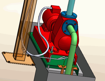

Routing Cables
Routing cables generates a 3D representation of the cable path within an electrical installation.
The routing paths and connection points facilitate the routing process. Segregation manages the rules applied to cable paths.
