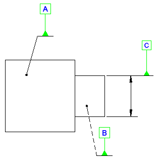

Examples:
Datum identifier symbol on a surface and on an extension line
Datum identifier symbol on a point
