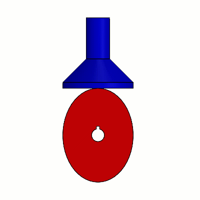

Continual curve-to-curve contact is useful for modeling assemblies that include cams, such as a valve lifter.
The point of contact between the flat plate curve and the oval cam curve changes, depending on the position and shape of the cam. The two component curves used to define the contact lie in the same plane.
