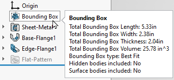

  • To view the bounding box dimensions, in the FeatureManager design tree, hover over the Bounding Box feature.
