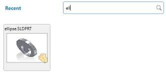

You can filter documents by type and by name on the Recent tab in the Welcome dialog box.
  • Tab navigates through the filters.
  • Enter or Spacebar turns a filter on or off.
When you filter a document by name, you can press Esc to clear the text.
You can filter to show only parts, assemblies, drawings, or top-level assembly documents. Quick filter and Filter by name work with each other. For example, click Filter Parts in the Quick filter and enter a file name in the Filter by name box. The system displays the part documents whose file name contains the text that you entered.
3DEXPERIENCE users can also open and filter recent local documents from the Home tab in the Open from 3DEXPERIENCE dialog box,
As you enter characters, only recent file names that match the characters appear as Recent files.
To search for more files on the 3DEXPERIENCE platform using 3DSearch, click Search more on 3DEXPERIENCE at the bottom of the Recent list.
To remove the filter, click Clear Filter next to 3DSearch.
