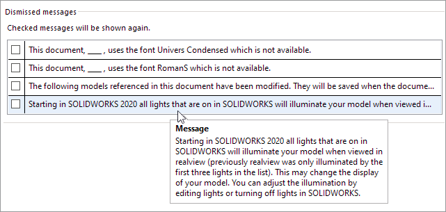

You can
restore messages that you dismissed.
Click
. Under Messages/Errors/Warnings, click
Dismissed Messages.
Dismissed messages
Lists messages that you suppress by selecting
Don't
ask me again (or other similar option) in a dialog box. Select
dismissed messages to restore them. Messages appear in the order that you dismissed
them. If a message is truncated, hover over it to display the full
message.
