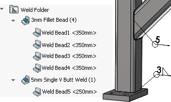

In this image, there are:
- Four 3mm Fillet Beads
- One 5mm Single V Butt Weld

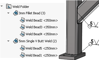

Select the Weld Bead
to change, then drag it to a different Weld
subfolder and drop it when the pointer changes to
You can drag multiple weld beads at the same time.
A dialog box alerts you that moving the weld bead changes the weld size and type.
Click OK.
The weld bead moves to the new
Weld
subfolder and its type, size, and symbol are updated. The
Weld
subfolder increments by the number of weld beads you added to the folder.
