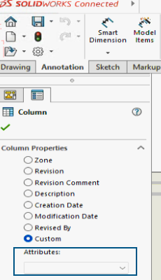

You can link 3DEXPERIENCE revision table columns to custom attributes created on the platform.
Custom attributes are similar to SOLIDWORKS file properties. They let you add extra descriptive information to part, assembly, or drawing files. You can store content on the cloud in a collaborative space.
Linking attributes means you only need to input information, such as name, revision, and description, in one place.
