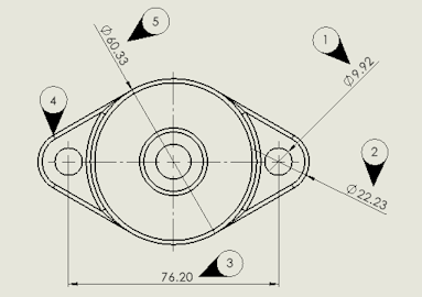

In drawings, you can tag inspection points according to VDA requirements. VDA balloons are frequently used in the German automotive industry.
You use circular balloons with a VDA leader type to create VDA balloons.

To add VDA balloons:
- Click Balloon
(Annotation toolbar), or click .
- Under Settings, for Balloon text, select Text.
- Click a location for the balloon.
A circular balloon appears.
- In the PropertyManager, click OK
- Click the balloon, and then in the PropertyManager, click More Properties.
- In the Note PropertyManager, under Leader, click VDA Leader
The balloon changes to a VDA balloon.
