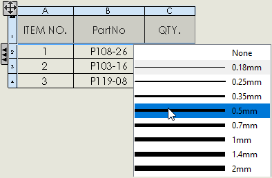

In tables, you can change the border thickness of individual cells,
selected groups of cells, and entire tables. You can also remove cell borders.
To change the cell border thickness:
Select one or more
cells.
To select cells, you can:
- Click, Ctrl + click, or
Shift + click in cells.
- Click a column letter or a row number.
- Click
to select the entire
table.
On the pop-up toolbar, click Border Edit
The pointer changes to
Move the pointer over a border of the selected cells.
when it is over a valid border.
Click one or more borders of the selected cells and select a
new border thickness.
You can:
- Continue clicking and changing other borders of the selected cells.
- Select None to remove the cell
border.
To turn off Border Edit
, click it on the toolbar or
click in a blank region of the graphics area.
Repeat steps 1 through 4 to change borders on other
cells.
