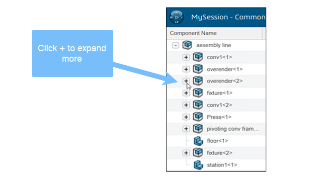

To view more of the file structure, you can:
  • Right-click a node and select Expand All or Collapse All.
  • Click the + icon next to a node.
  • Use the View options in the action bar:
    • Expand All
    • Expand in Levels
    • Collapse All
