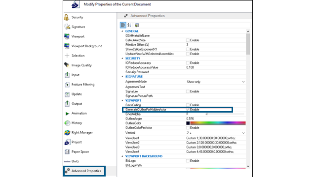

The GenerateOutlineForHiddenActor
property available in the Viewport category of the
Advanced
Properties
page specifies whether or not hidden actors are outlined in render mode.
To prevent outlines from being generated by
hidden actors, clear this option. This saves time
when using render mode for large assemblies.
