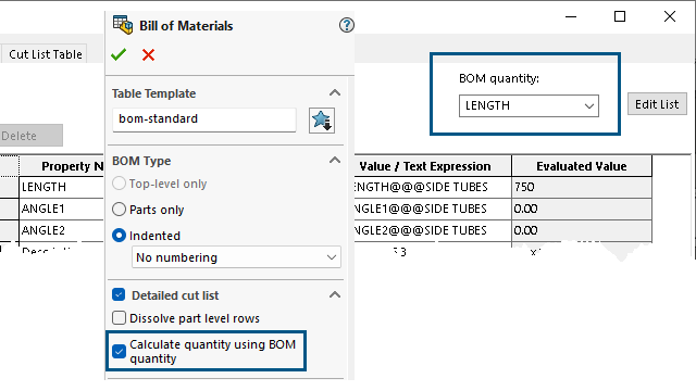

In the Bill of
Materials PropertyManager, you can
choose
an option for Detailed Cut List to use the BOM quantity in weldments.
When you select the
option, Calculate quantity using BOM quantity, the software
takes the property that you select in the BOM
quantity list and uses the value as the multiplier. If you clear the
option, the BOM table displays the quantity as the number of instances.
To use the BOM quantity override for detailed cut
lists:
- Click
Bill of Materials
(Table toolbar) or
- In the PropertyManager, select Detailed Cut
List
and Calculate quantity using BOM
quantity.
- Click
