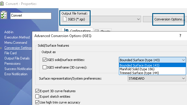

IGES (*.igs) Bounded Surface (type 143): Select to convert the faces of the part, assembly, or the selected surfaces and its boundaries defined by other IGES entities, for example, curves and edges.

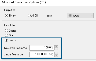

STL (*.stl) Custom option under Resolution with the following sub options:
  • Deviation Tolerance: Controls whole-part tessellation. Lower numbers generate files with greater whole-part accuracy.
  • Angle Tolerance: Controls small-detail tessellation. Lower numbers generate files with greater small-detail accuracy, but those files take longer to generate.
You can access these options under Tasks > Convert > Open > Conversion Settings > Conversion Options.
