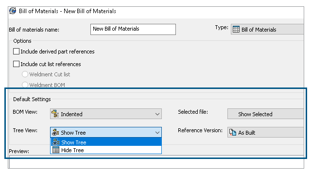

Administrators can specify the default view and options settings for the computed BOM while creating the Bill of Materials (BOM) in the SOLIDWORKS PDM Administration tool.
The default settings that the administrators specify apply to the BOM View and Options sections under the Bill of Materials tab in the SOLIDWORKS PDM File Explorer. The default settings are applicable to both the desktop and the Web2 client.
In the Administration tool, right-click Bill of Materials > New Bill of Materials. In the Bill of Materials - New Bill of Materials dialog box, under Default Settings, specify the default settings for the computed BOM.
