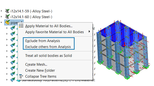

Exclude Bodies from Analysis You can exclude multiple bodies from an analysis. From a Simulation study tree, select a folder under the Parts node and use the shortcut menu to exclude all bodies in the selected folder from the analysis. Parent topicSOLIDWORKS Simulation
