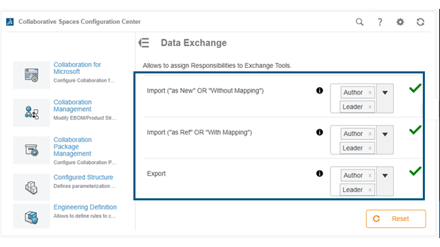

The 3DEXPERIENCE platform administrator can specify the user access controls for the Export as Package and Import Package commands in MySession. These commands are available when users enable the 3DEXPERIENCE Exchange add-in in SOLIDWORKS.
Benefits: Access controls define what users can and cannot do, and protect data integrity.
You must have administrator privileges to specify user access controls.
To specify user access:
  1. In the 3DEXPERIENCE platform, go to the Collaborative Spaces Configuration Center > Data Exchange.
  2. Select user permissions for the following commands:
    • Export: Author, Leader, Reader, or Contributor
    • Import ("as New" Or "Without Mapping": Author, Leader
