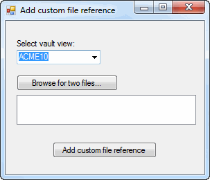

// Postconditions:
// 1. Displays the Add custom file reference dialog box.
//    a. Select a vault view.
//    b. Click Browse for two files
//       1. Locate and click two files in the root folder of the vault.
//       2. Click Open.
//       3. Checks out the first file.
//    c. Click Add custom file reference.
//    d. Click OK to close each message box.
// 2. Close the Add custom file reference dialog.

            //CustRefOpenFileDialog
            this.CustRefOpenFileDialog.Multiselect = true;
            //Form1
            this.AutoScaleDimensions = new System.Drawing.SizeF(6f, 13f);
            this.AutoScaleMode = System.Windows.Forms.AutoScaleMode.Font;
            this.ClientSize = new System.Drawing.Size(287, 222);
            this.Controls.Add(this.AddCustomFileReference);
            this.Controls.Add(this.CustRefListBox);
            this.Controls.Add(this.BrowseButton);
            this.Controls.Add(this.VaultsComboBox);
            this.Controls.Add(this.VaultsLabel);
            this.Name = "Form1";
            this.Text = "Add custom file reference";
            this.Load += new System.EventHandler(this.Form1_Load);
