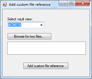

' Postconditions:
' 1. Displays the Add custom file reference dialog box.
'    a. Select a vault view.
'    b. Click Browse for two files
'       1. Locate and click two files in the root folder of the vault.
'       2. Click Open.
'       3. Checks out the first file.
'    c. Click Add custom file reference.
'    d. Click OK to close each message box.
' 2. Close the Add custom file reference dialog.

'Form1.Designer.vb
<Global.Microsoft.VisualBasic.CompilerServices.DesignerGenerated()> _
Partial Class Form1
    Inherits System.Windows.Forms.Form
    Private components As System.ComponentModel.IContainer = Nothing
    Protected Overrides Sub Dispose(ByVal disposing As Boolean)
        If disposing AndAlso (components IsNot NothingThen
            components.Dispose()
        End If
        MyBase.Dispose(disposing)
    End Sub
#Region "Windows Form Designer generated code"
    ''' <summary>
    ''' Required method for Designer support - do not modify
    ''' the contents of this method with the code editor.
    ''' </summary>
    Private Sub InitializeComponent()
        Me.VaultsLabel = New System.Windows.Forms.Label()
        Me.VaultsComboBox = New System.Windows.Forms.ComboBox()
        Me.BrowseButton = New System.Windows.Forms.Button()
        Me.CustRefListBox = New System.Windows.Forms.ListBox()
        Me.AddCustomFileReference = New System.Windows.Forms.Button()
        Me.CustRefOpenFileDialog = New System.Windows.Forms.OpenFileDialog()
        Me.SuspendLayout()
        'VaultsLabel
        Me.VaultsLabel.AutoSize = True
        Me.VaultsLabel.Location = New System.Drawing.Point(13, 26)
        Me.VaultsLabel.Name = "VaultsLabel"
        Me.VaultsLabel.Size = New System.Drawing.Size(91, 13)
        Me.VaultsLabel.TabIndex = 0
        Me.VaultsLabel.Text = "Select vault view:"
        'VaultsComboBox
        Me.VaultsComboBox.FormattingEnabled = True
        Me.VaultsComboBox.Location = New System.Drawing.Point(16, 42)
        Me.VaultsComboBox.Name = "VaultsComboBox"
        Me.VaultsComboBox.Size = New System.Drawing.Size(121, 21)
        Me.VaultsComboBox.TabIndex = 1
        'BrowseButton
        Me.BrowseButton.Location = New System.Drawing.Point(16, 78)
        Me.BrowseButton.Name = "BrowseButton"
        Me.BrowseButton.Size = New System.Drawing.Size(146, 23)
        Me.BrowseButton.TabIndex = 3
        Me.BrowseButton.Text = "Browse for two files..."
        Me.BrowseButton.UseVisualStyleBackColor = True
        'CustRefListBox
        Me.CustRefListBox.FormattingEnabled = True
        Me.CustRefListBox.HorizontalScrollbar = True
        Me.CustRefListBox.Location = New System.Drawing.Point(16, 107)
        Me.CustRefListBox.Name = "CustRefListBox"
        Me.CustRefListBox.SelectionMode = System.Windows.Forms.SelectionMode.MultiExtended
        Me.CustRefListBox.Size = New System.Drawing.Size(259, 56)
        Me.CustRefListBox.TabIndex = 4
        'AddCustomFileReference
        Me.AddCustomFileReference.Location = New System.Drawing.Point(68, 175)
        Me.AddCustomFileReference.Name = "AddCustomFileReference"
        Me.AddCustomFileReference.Size = New System.Drawing.Size(150, 23)
        Me.AddCustomFileReference.TabIndex = 5
        Me.AddCustomFileReference.Text = "Add custom file reference"
        Me.AddCustomFileReference.UseVisualStyleBackColor = True
        'CustRefOpenFileDialog
        Me.CustRefOpenFileDialog.Multiselect = True
        'Form1
        Me.AutoScaleDimensions = New System.Drawing.SizeF(6.0!, 13.0!)
        Me.AutoScaleMode = System.Windows.Forms.AutoScaleMode.Font
        Me.ClientSize = New System.Drawing.Size(287, 222)
        Me.Controls.Add(Me.AddCustomFileReference)
        Me.Controls.Add(Me.CustRefListBox)
        Me.Controls.Add(Me.BrowseButton)
        Me.Controls.Add(Me.VaultsComboBox)
        Me.Controls.Add(Me.VaultsLabel)
        Me.Name = "Form1"
        Me.Text = "Add custom file reference"
        Me.ResumeLayout(False)
        Me.PerformLayout()
    End Sub
#End Region
    Friend WithEvents VaultsLabel As System.Windows.Forms.Label
    Friend WithEvents VaultsComboBox As System.Windows.Forms.ComboBox
    Friend WithEvents BrowseButton As System.Windows.Forms.Button
    Friend WithEvents CustRefListBox As System.Windows.Forms.ListBox
    Friend WithEvents AddCustomFileReference As System.Windows.Forms.Button
    Friend WithEvents CustRefOpenFileDialog As System.Windows.Forms.OpenFileDialog
End Class
