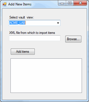

Add Items Example (C#)
This example shows how to add items to a vault. The data for the items is imported from an XML file, which is read by the .NET XmlReader.
NOTE: If using the primary interop assembly provided with SOLIDWORKS PDM Professional, see Using .NET Framework 4.0 in Stand-alone Applications.
// Preconditions:
//  1. Create an XML file for this example.
//     a. Open a text editor like Notepad and copy and paste this code
//        into the editor.
//     b. Save the file as Items.xml and remember where you save the file.
//  2. Open the SOLIDWORKS PDM Professional Administration tool.
//  3. Log into the vault where to add a new serial number.
//     a. Right-click Serial Numbers and click New Serial Number.
//        1. Type AddItems in Name.
//        2. For Format string, click the right-arrow button and select Counter value > 00001.
//        3. Click OK.
//     b. Right-click Items and select Open.
//        1. Click AddItems in Item Serial Number.
//        2. Click OK.
//  4. Start Microsoft Visual Studio.
//     a. Click File > New > Project > C#, Windows, Desktop > Windows Forms Application.
//     b. Type AddItems in Project name.
//     c. For Location, click ... and navigate to the folder where to
create the project.
//     d. Click Next.
//     e. Select Framework.
//     f. Click Create.
//    g. Click Show All Files in the Solution Explorer toolbar and expand
//       Form1.cs in the Solution Explorer.
//     h. Replace the code in Form1.cs with this code. //     i. Replace the code in Form1.Designer.cs with this code. //     j. Right-click the AddItemsCSharp project name in the Solution Explorer. //        1. Click Add > Class > Class. //        2. Type EdmVaultSingleton.cs in Name. //        3. Click Add. //        4. Replace the code in EdmVaultSingleton.cs with this code. //     k. Right-click the AddItems project name in the Solution Explorer. //        1. Click Add > Class > Class. //        2. Type NewItem.cs in Name. //        3. Click Add. //        4. Replace the code in NewItem.cs with this code. //  5. Add dependencies and safely pass arrays of structures. //  6. Click Debug > Start Debugging or press F5. // // Postconditions:  //  1. Displays a dialog. //  2. Select a vault. //  3. Click the Browse button, locate and select Items.xml, and click Open. //  4. Click the Add items button. //     The new items are printed in the dialog's list. //  5. Close the dialog. //  6. Open the SOLIDWORKS PDM Professional Item Explorer tool.  //     (In Windows 7, click Start > All Programs > SOLIDWORKS PDM Professional >  // Item Explorer.) //  7. Expand the vault where the new items were added.  //     The new items are listed below the name of the expanded vault.  //----------------------------------------------------------------------------

//Form1.cs
using System;
using System.IO;
using EPDM.Interop.epdm;
using System.Collections;
using System.Diagnostics;
using System.Runtime.InteropServices;
using System.Windows.Forms;
namespace AddItemsCSharp
    public partial class Form1 : Form
        public Form1()
            InitializeComponent();
        void BrowseButton_Click(System.Object sender, System.EventArgs e)
            try
                DialogResult dlgResult = XmlOpenFileDialog.ShowDialog();
                if (dlgResult == DialogResult.Cancel)
                    return;
                XmlTextBox.Text = XmlOpenFileDialog.FileName;
            catch (System.Runtime.InteropServices.COMException ex)

        public void AddItemsButton_Click(System.Object sender, System.EventArgs e)
            try
                ItemsListBox.Items.Clear();
                ArrayList NewItems = new ArrayList();
                using (System.Xml.XmlReader XmlReader = System.Xml.XmlReader.Create(XmlTextBox.Text))
                    XmlReader.Read();
                    XmlReader.ReadToNextSibling("ArrayOfAnyType");
                    XmlReader.ReadToDescendant("anyType");
                    do
                        NewItem CurItem = new NewItem();
                        XmlReader.ReadToDescendant("Description");

        public void AddItems_Load(System.Object sender, System.EventArgs e)
            try
                //Obtain the only instance of the IEdmVault object
                IEdmVault8 vault = (IEdmVault8)EdmVaultSingleton.Instance;
                EdmViewInfo[] Views = null;
                vault.GetVaultViews(out Views, false);

            this.XmlLabel.Text = "XML file from which to import items:";
            // XmlTextBox
            this.XmlTextBox.Location = new System.Drawing.Point(28, 107);
            this.XmlTextBox.Name = "XmlTextBox";
            this.XmlTextBox.Size = new System.Drawing.Size(171, 20);
            this.XmlTextBox.TabIndex = 3;
            // BrowseButton
            this.BrowseButton.Location = new System.Drawing.Point(216, 107);
            this.BrowseButton.Name = "BrowseButton";
            this.BrowseButton.Size = new System.Drawing.Size(75, 23);
            this.BrowseButton.TabIndex = 4;
            this.BrowseButton.Text = "Browse...";
            this.BrowseButton.UseVisualStyleBackColor = true;
            this.BrowseButton.Click += new System.EventHandler(this.BrowseButton_Click);
            // AddItemsButton
            this.AddItemsButton.Location = new System.Drawing.Point(28, 149);
            this.AddItemsButton.Name = "AddItemsButton";
            this.AddItemsButton.Size = new System.Drawing.Size(75, 23);
            this.AddItemsButton.TabIndex = 5;
            this.AddItemsButton.Text = "Add items";
            this.AddItemsButton.UseVisualStyleBackColor = true;
            this.AddItemsButton.Click += new System.EventHandler(this.AddItemsButton_Click);
            // ItemListBox
            this.ItemsListBox.FormattingEnabled = true;
            this.ItemsListBox.Location = new System.Drawing.Point(28, 196);
            this.ItemsListBox.Name = "ItemsListBox";
            this.ItemsListBox.Size = new System.Drawing.Size(263, 95);
            this.ItemsListBox.TabIndex = 6;
            // Form1
            this.AutoScaleDimensions = new System.Drawing.SizeF(6F, 13F);
            this.AutoScaleMode = System.Windows.Forms.AutoScaleMode.Font;
            this.ClientSize = new System.Drawing.Size(334, 311);
            this.Controls.Add(this.ItemsListBox);
            this.Controls.Add(this.AddItemsButton);
            this.Controls.Add(this.BrowseButton);
            this.Controls.Add(this.XmlTextBox);
            this.Controls.Add(this.XmlLabel);
            this.Controls.Add(this.VaultsComboBox);
            this.Controls.Add(this.VaultsLabel);
            this.Name = "Form1";
            this.Text = "Add new items";
            this.Load  += new System.EventHandler(this.AddItems_Load);
            this.ResumeLayout(false);
            this.PerformLayout();
        #endregion
