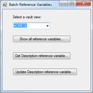

 Postconditions:
'  1. The Batch Reference Variables dialog box displays.
'     a. Select a vault view.
'     b. Click Show all reference variables.
'        1. In the Select Parent File dialog, select the assembly file identified
'           in Preconditions step 5 and click Open.
'        2. In the Select Child File dialog, select a part file referenced by the
'           assembly file and click Open.
'           Displays all of the reference variables for all configurations.
'        3. Click OK in the dialog box.
'     c. Click Get Description reference variable.
'        1.
'        2.
'           Displays the current value of reference variable, Description.
'     d. Click Update Description reference variable.
'        1.
'        2.
'        3. Type a new description and click OK.
'        4. Click OK in the dialog box.
'  2. Close the Batch Reference Variables dialog box.

    'It can be modified using the Windows Form Designer.
    'Do not modify it using the code editor.
    <System.Diagnostics.DebuggerStepThrough()> _
    Private Sub InitializeComponent()
        Me.VaultsComboBox = New System.Windows.Forms.ComboBox()
        Me.VaultsLabel = New System.Windows.Forms.Label()
        Me.Button1 = New System.Windows.Forms.Button()
        Me.Button2 = New System.Windows.Forms.Button()
        Me.Button3 = New System.Windows.Forms.Button()
        Me.SuspendLayout()
        'VaultsComboBox
        Me.VaultsComboBox.FormattingEnabled = True
        Me.VaultsComboBox.Location = New System.Drawing.Point(33, 43)
        Me.VaultsComboBox.Name = "VaultsComboBox"
        Me.VaultsComboBox.Size = New System.Drawing.Size(121, 21)
        Me.VaultsComboBox.TabIndex = 0
        'VaultsLabel
        Me.VaultsLabel.AutoSize = True
        Me.VaultsLabel.Location = New System.Drawing.Point(30, 18)
        Me.VaultsLabel.Name = "VaultsLabel"
        Me.VaultsLabel.Size = New System.Drawing.Size(100, 13)
        Me.VaultsLabel.TabIndex = 1
        Me.VaultsLabel.Text = "Select a vault view:"
        'Button1
        Me.Button1.Location = New System.Drawing.Point(33, 84)
        Me.Button1.Name = "Button1"
        Me.Button1.Size = New System.Drawing.Size(187, 23)
        Me.Button1.TabIndex = 2
        Me.Button1.Text = "Show all reference variables..."
        Me.Button1.UseVisualStyleBackColor = True
        'Button2
        Me.Button2.Location = New System.Drawing.Point(33, 138)
        Me.Button2.Name = "Button2"
        Me.Button2.Size = New System.Drawing.Size(187, 24)
        Me.Button2.TabIndex = 3
        Me.Button2.Text = "Get Description reference variable..."
        Me.Button2.UseVisualStyleBackColor = True
        'Button3
        Me.Button3.Location = New System.Drawing.Point(33, 190)
        Me.Button3.Name = "Button3"
        Me.Button3.Size = New System.Drawing.Size(208, 23)
        Me.Button3.TabIndex = 4
        Me.Button3.Text = "Update Description reference variable..."
        Me.Button3.UseVisualStyleBackColor = True
        'Form1
        Me.AutoScaleDimensions = New System.Drawing.SizeF(6.0!, 13.0!)
        Me.AutoScaleMode = System.Windows.Forms.AutoScaleMode.Font
        Me.ClientSize = New System.Drawing.Size(284, 262)
        Me.Controls.Add(Me.Button3)
        Me.Controls.Add(Me.Button2)
        Me.Controls.Add(Me.Button1)
        Me.Controls.Add(Me.VaultsLabel)
        Me.Controls.Add(Me.VaultsComboBox)
        Me.Name = "Form1"
        Me.Text = "Batch Reference Variables"
        Me.ResumeLayout(False)
        Me.PerformLayout()
    End Sub
    Friend WithEvents VaultsComboBox As System.Windows.Forms.ComboBox
    Friend WithEvents VaultsLabel As System.Windows.Forms.Label
    Friend WithEvents Button1 As System.Windows.Forms.Button
    Friend WithEvents Button2 As System.Windows.Forms.Button
    Friend WithEvents Button3 As System.Windows.Forms.Button
End Class
