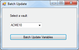

// Postconditions:
//  1. Displays the Batch Update dialog box.
//     a. Select a vault.
//     b. Click Batch Update Variables.
//        * Updates the Title and Comment variables in the data cards
//          only of checked-out text files.
//        * Updates the Description variable of the data cards of all folders
//          with the word Folder in their names.
//        * Displays a message box saying Card variables updated.
//     c. Click OK to close the message box.
//  2. Close the Batch Update dialog box.
//  3. Inspect the data cards of any checked-out text files and folders with
//     the word Folder in their names in the selected vault.

//Form1.Designer.cs
namespace BatchUpdateCardVarsCSharp
    partial class Form1
        /// <summary>
        /// Required designer variable.
        /// </summary>
        private System.ComponentModel.IContainer components = null;
        /// <summary>
        /// Clean up any resources being used.
        /// </summary>
        /// <param name="disposing">true if managed resources should be disposed; otherwise, false.</param>
        protected override void Dispose(bool disposing)
            if (disposing && (components != null))
                components.Dispose();
            base.Dispose(disposing);
        #region Windows Form Designer generated code
        /// <summary>
        /// Required method for Designer support - do not modify
        /// the contents of this method with the code editor.
        /// </summary>
        private void InitializeComponent()
            this.BatchUpdateButton = new System.Windows.Forms.Button();
            this.VaultsComboBox = new System.Windows.Forms.ComboBox();
            this.Label1 = new System.Windows.Forms.Label();
            this.SuspendLayout();
            //BatchUpdateButton
            this.BatchUpdateButton.Location = new System.Drawing.Point(30, 100);
            this.BatchUpdateButton.Name = "BatchUpdateButton";
            this.BatchUpdateButton.Size = new System.Drawing.Size(215, 23);
            this.BatchUpdateButton.TabIndex = 0;
            this.BatchUpdateButton.Text = "Batch Update Variables";
            this.BatchUpdateButton.UseVisualStyleBackColor = true;
            this.BatchUpdateButton.Click += new System.EventHandler(this.BatchUpdateButton_Click);
            //VaultsComboBox
            this.VaultsComboBox.FormattingEnabled = true;
            this.VaultsComboBox.Location = new System.Drawing.Point(30, 56);
            this.VaultsComboBox.Name = "VaultsComboBox";
            this.VaultsComboBox.Size = new System.Drawing.Size(121, 21);
            this.VaultsComboBox.TabIndex = 1;
            //Label1
            this.Label1.AutoSize = true;
            this.Label1.Location = new System.Drawing.Point(27, 23);
            this.Label1.Name = "Label1";
            this.Label1.Size = new System.Drawing.Size(91, 13);
            this.Label1.TabIndex = 2;
            this.Label1.Text = "Select vault view:";
            //Form1
            this.AutoScaleDimensions = new System.Drawing.SizeF(6f, 13f);
            this.AutoScaleMode = System.Windows.Forms.AutoScaleMode.Font;
            this.ClientSize = new System.Drawing.Size(284, 153);
            this.Controls.Add(this.Label1);
            this.Controls.Add(this.VaultsComboBox);
            this.Controls.Add(this.BatchUpdateButton);
            this.Name = "Form1";
            this.Text = "Batch Update";
            this.Load += new System.EventHandler(this.Form1_Load);
            this.ResumeLayout(false);
            this.PerformLayout();
        internal System.Windows.Forms.Button BatchUpdateButton;
        internal System.Windows.Forms.ComboBox VaultsComboBox;
        internal System.Windows.Forms.Label Label1;
        #endregion
Back to top
