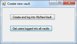

' 1. Displays the Create new vault dialog box.
'    a. Click Create and log in to MyNewVault.
'    b. After a few seconds, displays a login dialog.
'    c. Type Admin's password in Password.
'    d. Click Log in.
'       1. MyNewVault is created using the Default configuration in the root
'          folder of the archive server.
'       2. A view of MyNewVault, accessible to all users, is created in c:\temp.
'       3. Admin is logged into MyNewVault.
'    e. Click Get users logged into all vaults
'    f. Displays a dialog with all of the users currently logged into
'       vault views on this machine.
'    g. Click OK.

        Me.GetLoggedIn = New System.Windows.Forms.Button()
        Me.Button1 = New System.Windows.Forms.Button()
        Me.SuspendLayout()
        'GetLoggedIn
        Me.GetLoggedIn.Location = New System.Drawing.Point(31, 71)
        Me.GetLoggedIn.Name = "GetLoggedIn"
        Me.GetLoggedIn.Size = New System.Drawing.Size(167, 23)
        Me.GetLoggedIn.TabIndex = 5
        Me.GetLoggedIn.Text = "Get users logged into all vaults"
        Me.GetLoggedIn.UseVisualStyleBackColor = True
        'Button1
        Me.Button1.Location = New System.Drawing.Point(31, 26)
        Me.Button1.Name = "Button1"
        Me.Button1.Size = New System.Drawing.Size(178, 23)
        Me.Button1.TabIndex = 6
        Me.Button1.Text = "Create and log in to MyNewVault"
        Me.Button1.UseVisualStyleBackColor = True
