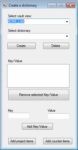

This example shows how to create and delete dictionaries and their keys and values.
NOTE: If using the primary interop assembly provided with SOLIDWORKS PDM Professional, see Using .NET Framework 4.0 in Stand-alone Applications.
' Preconditions:
' 1. Start Microsoft Visual Studio.
'    a. Click File > New > Project > Visual Basic, Windows, Desktop > Windows Forms App.
'    b. Type AddDictionary in Project name.
'    c. For Location, click ... and navigate to the folder where to
create the project.
'      d. Click Next.
'    e. Select Framework.
'    f. Click Create
'    g. Click Show All Files in the Solution Explorer toolbar and expand
'       Form1.vb in the Solution Explorer.
'    h. Replace the code in Form1.vb with this code. '    i. To create the form, replace the code in Form1.Designer.vb with this code. ' 2. Add dependencies and safely pass arrays of structures. ' 3. Click Debug > Start Debugging or press F5. ' ' Postconditions:  ' 1. Displays a dialog. ' 2. Select a vault. ' 3. Select the Projects dictionary. '    a. Click Create. '    b. Click Add project items. '       The Key/Value list is populated with the  '       Projects dictionary's keys and values. '    c. Type a unique value in Key and any value in Value. '    d. Click Add Key/Value. '       The key and value are added to the Key/Value list. ' e. Select a key and value in the Key/Value list and ' click Remove selected Key/Value. ' The selected key and value are deleted from the ' dictionary. ' f. Type an existing key in Key and any value in Value. ' g. Click Add Key/Value. ' A message box is displayed informing you that the ' duplicate keys are prohibited. Neither the key ' nor value was added to the dictionary. ' h. Click OK to close the message box. ' 4. Select the Counters dictionary. ' a. Click Create. '    b. Click Add counter items. '       The Key/Value list is populated with the Counters  ' dictionary's keys and values. ' 5. Experiment with creating your own dictionary and adding ' and removing keys and values to and from that dictionary. ' 6. Close the dialog. '---------------------------------------------------------------------------- 'Form1.vb Imports EPDM.Interop.epdm Public Class AddDictionary     Private vault As IEdmVault5 = Nothing     Private Sub AddDictionary_Load(ByVal sender As System.ObjectByVal e As System.EventArgsHandles MyBase.Load         Try             vault = New EdmVault5             Dim Views() As EdmViewInfo = Nothing             DirectCast(vault, IEdmVault8).GetVaultViews(Views, False)             VaultsComboBox.Items.Clear()             For Each View As EdmViewInfo In Views                 VaultsComboBox.Items.Add(View.mbsVaultName)             Next             If VaultsComboBox.Items.Count > 0 Then                 VaultsComboBox.Text = VaultsComboBox.Items(0)             End If         Catch ex As Runtime.InteropServices.COMException             MessageBox.Show("HRESULT = 0x" + _               ex.ErrorCode.ToString("X") + vbCrLf + _               ex.Message)         Catch ex As Exception             MessageBox.Show(ex.Message)         End Try     End Sub     Private Sub AddProjectItemsButton_Click( _       ByVal sender As System.Object, _       ByVal e As System.EventArgs) _       Handles AddProjectItemsButton.Click         Try             If Not vault.IsLoggedIn Then                 'Log into selected vault as the current user                 vault.LoginAuto(VaultsComboBox.Text, _                   Me.Handle.ToInt32())             End If             Dim ProjectDictionary As IEdmDictionary5             ProjectDictionary = vault.GetDictionary( _               "Projects"True'Create it if it doesn't exist             'Add the new dictionary name to the combo box             'if it doesn't exist             If Not DictionaryComboBox.Items.Contains( _                 "Projects"Then                 DictionaryComboBox.Items.Add("Projects")             End If             Dim SuccessSet As Boolean = False             SuccessSet = ProjectDictionary.StringTestAndSetAt _               ("1000""Mercedes Benz")             SuccessSet = ProjectDictionary.StringTestAndSetAt _               ("1001""Lexus")             SuccessSet = ProjectDictionary.StringTestAndSetAt _               ("1002""Porche")             SuccessSet = ProjectDictionary.StringTestAndSetAt _               ("1003""Audi")             SuccessSet = ProjectDictionary.StringTestAndSetAt _               ("1004""BMW")             SuccessSet = ProjectDictionary.StringTestAndSetAt _               ("1005""Jaguar")             If DictionaryComboBox.Text = "Projects" Then                 DisplayDictionaryItems("Projects", _                   ProjectDictionary, KeyValueListBox)             Else                 DictionaryComboBox.Text = "Projects"             End If         Catch ex As Runtime.InteropServices.COMException             MessageBox.Show("HRESULT = 0x" + _             ex.ErrorCode.ToString("X") + vbCrLf + _             ex.Message)         Catch ex As Exception             MessageBox.Show(ex.Message)         End Try     End Sub     Private Sub DictionaryComboBox_SelectedIndexChanged( _       ByVal sender As System.Object, _       ByVal e As System.EventArgs) _       Handles DictionaryComboBox.SelectedIndexChanged         Try             If Not vault.IsLoggedIn Then                 'Log into selected vault as the current user                 vault.LoginAuto(VaultsComboBox.Text, _                    Me.Handle.ToInt32())             End If             'Get the selected dictionary, if it exists             Dim Dictionary As IEdmDictionary5             Dictionary = vault.GetDictionary( _               DictionaryComboBox.Text, False)             'Display the dictionary contents             DisplayDictionaryItems( _               DictionaryComboBox.Text, _               Dictionary, KeyValueListBox)         Catch ex As Runtime.InteropServices.COMException             MessageBox.Show("HRESULT = 0x" + _             ex.ErrorCode.ToString("X") + vbCrLf + _             ex.Message)         Catch ex As Exception             MessageBox.Show(ex.Message)         End Try     End Sub     Private Sub CreateButton_Click( _       ByVal sender As System.Object, _       ByVal e As System.EventArgs) _       Handles CreateButton.Click         Try             KeyValueListBox.Items.Clear()             If Not vault.IsLoggedIn Then                 'Log into selected vault as the current user                 vault.LoginAuto(VaultsComboBox.Text, _                    Me.Handle.ToInt32())             End If             'Get the selected dictionary, if it exists             Dim Dictionary As IEdmDictionary5             Dictionary = vault.GetDictionary( _               DictionaryComboBox.Text, False)             'If it doesn't exist, create it             If Dictionary Is Nothing Then                 'Create it, because it doesn't exist                 Dictionary = vault.GetDictionary( _                   DictionaryComboBox.Text, True)                 KeyValueListBox.Items.Add( _                   DictionaryComboBox.Text + _                   " dictionary created.")             Else                 'If it does exist, inform the user                 KeyValueListBox.Items.Add( _                   DictionaryComboBox.Text + _                   " dictionary already exists.")             End If             'Add the new dictionary name to the combo box,             'if it doesn't exist             If Not DictionaryComboBox.Items.Contains( _                               DictionaryComboBox.Text) Then                 DictionaryComboBox.Items.Add( _                   DictionaryComboBox.Text)             End If         Catch ex As Runtime.InteropServices.COMException             MessageBox.Show("HRESULT = 0x" + _             ex.ErrorCode.ToString("X") + vbCrLf + _             ex.Message)         Catch ex As Exception             MessageBox.Show(ex.Message)         End Try     End Sub     Private Sub DeleteButton_Click( _       ByVal sender As System.Object, _       ByVal e As System.EventArgs) _       Handles DeleteButton.Click         Try             KeyValueListBox.Items.Clear()             If Not vault.IsLoggedIn Then                 'Log into selected vault as the current user                 vault.LoginAuto(VaultsComboBox.Text, _                    Me.Handle.ToInt32())             End If             'Get the selected dictionary, if it exists             Dim Dictionary As IEdmDictionary5             Dictionary = vault.GetDictionary( _               DictionaryComboBox.Text, False)             'If it doesn't exist, inform the user             If Dictionary Is Nothing Then                 KeyValueListBox.Items.Add( _                   DictionaryComboBox.Text + _                   " dictionary doesn't exist.")                 'If it does exist, delete it and inform the user             Else                 Dictionary.RemoveDictionary()                 KeyValueListBox.Items.Add( _                   DictionaryComboBox.Text + _                   " dictionary deleted.")             End If             'Remove the dictionary name from the list box             DictionaryComboBox.Items.Remove( _               DictionaryComboBox.Text)         Catch ex As Runtime.InteropServices.COMException             MessageBox.Show("HRESULT = 0x" + _             ex.ErrorCode.ToString("X") + vbCrLf + _             ex.Message)         Catch ex As Exception             MessageBox.Show(ex.Message)         End Try     End Sub     Private Sub AddKeyValueButton_Click( _       ByVal sender As System.Object, _       ByVal e As System.EventArgs) _       Handles AddKeyValueButton.Click         Try             If Not vault.IsLoggedIn Then                 'Log into selected vault as the current user                 vault.LoginAuto(VaultsComboBox.Text, _                    Me.Handle.ToInt32())             End If             Dim Dictionary As IEdmDictionary5             Dictionary = vault.GetDictionary( _               DictionaryComboBox.Text, False)             'Make sure that the user has typed valid data             If KeyTextBox.Text = "" _                 Or ValueTextBox.Text = "" Then                 MessageBox.Show("Please type a key and a value.")                 Exit Sub             End If             'Add the data if it doesn't exist in the dictionary             Dim SuccessSet As Boolean = False             SuccessSet = Dictionary.StringTestAndSetAt( _               KeyTextBox.Text, ValueTextBox.Text)             If Not SuccessSet Then                 MessageBox.Show("The value you typed for Key already exists; duplicate keys are prohibited. Neither the key or value was added to this dictionary. Try again.")             Else                 DisplayDictionaryItems(DictionaryComboBox.Text, _                   Dictionary, KeyValueListBox)                 KeyTextBox.Text = ""                 ValueTextBox.Text = ""             End If         Catch ex As Runtime.InteropServices.COMException             MessageBox.Show("HRESULT = 0x" + _             ex.ErrorCode.ToString("X") + vbCrLf + _             ex.Message)         Catch ex As Exception             MessageBox.Show(ex.Message)         End Try     End Sub     Private Sub RemoveButton_Click( _       ByVal sender As System.Object, _       ByVal e As System.EventArgs) _       Handles RemoveButton.Click         Try             If KeyValueListBox.SelectedIndex = -1 Then                 MessageBox.Show("No Key/Value selected.")                 Exit Sub             End If             Dim KeyValue As String             KeyValue = KeyValueListBox.Items( _               KeyValueListBox.SelectedIndex)             Dim key As String             key = Split(KeyValue, vbTab)(0)             If Not vault.IsLoggedIn Then                 'Log into selected vault as the current user                 vault.LoginAuto(VaultsComboBox.Text, _                    Me.Handle.ToInt32())             End If             Dim Dictionary As IEdmDictionary5             Dictionary = vault.GetDictionary( _               DictionaryComboBox.Text, False)             Dictionary.StringRemoveAt(key)             KeyValueListBox.Items.Remove(KeyValue)         Catch ex As Runtime.InteropServices.COMException             MessageBox.Show("HRESULT = 0x" + _             ex.ErrorCode.ToString("X") + vbCrLf + _             ex.Message)         Catch ex As Exception             MessageBox.Show(ex.Message)         End Try     End Sub     Private Sub AddCounterItemsButton_Click( _       ByVal sender As System.Object, _       ByVal e As System.EventArgs) _       Handles AddCounterItemsButton.Click         Try             If Not vault.IsLoggedIn Then                 'Log into selected vault as the current user                 vault.LoginAuto(VaultsComboBox.Text, _                    Me.Handle.ToInt32())             End If             Dim CounterDictionary As IEdmDictionary5             CounterDictionary = vault.GetDictionary _               ("Counters"True'Create it, if it doesn't exist             'Add the new dictionary name to the list box,             'if it doesn't exist             If Not DictionaryComboBox.Items.Contains( _                 "Counters"Then                 DictionaryComboBox.Items.Add("Counters")             End If             Dim SuccessSet As Boolean = False             SuccessSet = CounterDictionary.StringTestAndSetAt _               ("Electric""5")             SuccessSet = CounterDictionary.StringTestAndSetAt _               ("Hybrid""10")             SuccessSet = CounterDictionary.StringTestAndSetAt _               ("Gasoline""15")             SuccessSet = CounterDictionary.StringTestAndSetAt _               ("Diesel""20")             If DictionaryComboBox.Text = "Counters" Then                 DisplayDictionaryItems("Counters", _                   CounterDictionary, KeyValueListBox)             Else                 DictionaryComboBox.Text = "Counters"             End If         Catch ex As Runtime.InteropServices.COMException             MessageBox.Show("HRESULT = 0x" + _             ex.ErrorCode.ToString("X") + vbCrLf + _             ex.Message)         Catch ex As Exception             MessageBox.Show(ex.Message)         End Try     End Sub     Private Sub DisplayDictionaryItems( _       ByVal DictionaryName As String, _       ByVal Dictionary As IEdmDictionary5, _       ByVal ListObject As Object)         Try             ListObject.Items.Clear()             If Dictionary Is Nothing Then                 ListObject.Items.Add(DictionaryComboBox.Text + _                   " dictionary doesn't exist.")             Else                 'Traverse and display the Key/Value pairs                 'in the dictionary                 Dim Key As String = ""                 Dim Value As String = ""                 Dim Pos As IEdmPos5                 Pos = Dictionary.StringGetFirstPosition()                 While Not Pos.IsNull                     Dictionary.StringGetNextAssoc(Pos, Key, Value)                     ListObject.Items.Add(Key + vbTab + Value)                 End While             End If         Catch ex As Runtime.InteropServices.COMException             MessageBox.Show("HRESULT = 0x" + _             ex.ErrorCode.ToString("X") + vbCrLf + _             ex.Message)         Catch ex As Exception             MessageBox.Show(ex.Message)         End Try     End Sub End Class
'Form1.Designer.vb
