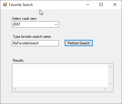

// 20. Click Debug > Start Debugging or press F5.
// // Postconditions:  //  1. Displays a dialog.
//  2. Select a vault. // 3. Type in a favorite search name.
//  4. Click Perform Search.
//  5. Displays search results, including the custom search column, Description.
//  6. Close the dialog.

        public void PerformSearch_Click(System.Object sender, System.EventArgs e)
            try
                IEdmVault9 vault2 = null;
                if (vault1 == null)
                    vault1 = new EdmVault5();
                vault2 = (IEdmVault9)vault1;
                if (!vault1.IsLoggedIn)
                    vault1.LoginAuto(VaultsComboBox.Text, this.Handle.ToInt32());
                IEdmSearch10 oSearch = (IEdmSearch10)vault1.CreateSearch();
                IEdmSearchResult6 oSearchResult = (IEdmSearchResult6)oSearch.GetFirstFavoriteResult(TextBox1.Text, true); // get custom search result columns, if present
