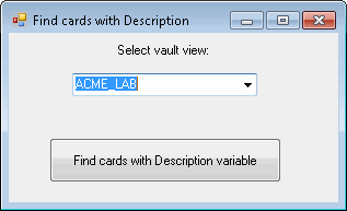

Find Data Cards with Description Variable Example (VB.NET)
This example shows how to find the data cards in your vault that have a Description variable.

'  9. Replace the code in Form1.vb with this code. ' 10. Replace the code in Form1.Designer.vb with this code. ' 11. Add dependencies and safely pass arrays of structures. ' 12. Open the Immediate window. ' 13. Click Debug > Start Debugging or press F5. ' ' Postconditions:  '  1. Displays a dialog. '  2. Select a vault. '  3. Click the Find cards with Description variable button. '     The cards in your vault with a Description variable are '     printed to the Immediate window.  '  4. Examine the Immediate window. '  5. Close the dialog. '----------------------------------------------------------------------------

        Me.FindCardsButton = New System.Windows.Forms.Button()
        Me.VaultsComboBox = New System.Windows.Forms.ComboBox()
        Me.VaultsLabel = New System.Windows.Forms.Label()
        Me.SuspendLayout()
        'FindCardsButton
        Me.FindCardsButton.Location = New System.Drawing.Point(37, 96)
        Me.FindCardsButton.Margin = New System.Windows.Forms.Padding(2)
        Me.FindCardsButton.Name = "FindCardsButton"
        Me.FindCardsButton.Size = New System.Drawing.Size(212, 41)
        Me.FindCardsButton.TabIndex = 20
        Me.FindCardsButton.Text = "Find cards with Description variable"
        Me.FindCardsButton.UseVisualStyleBackColor = True
        'VaultsComboBox
        Me.VaultsComboBox.FormattingEnabled = True
        Me.VaultsComboBox.Location = New System.Drawing.Point(58, 37)
        Me.VaultsComboBox.Margin = New System.Windows.Forms.Padding(2)
        Me.VaultsComboBox.Name = "VaultsComboBox"
        Me.VaultsComboBox.Size = New System.Drawing.Size(169, 21)
        Me.VaultsComboBox.TabIndex = 19
        'VaultsLabel
        Me.VaultsLabel.AutoSize = True
        Me.VaultsLabel.Location = New System.Drawing.Point(96, 9)
        Me.VaultsLabel.Margin = New System.Windows.Forms.Padding(2, 0, 2, 0)
        Me.VaultsLabel.Name = "VaultsLabel"
        Me.VaultsLabel.Size = New System.Drawing.Size(91, 13)
        Me.VaultsLabel.TabIndex = 18
        Me.VaultsLabel.Text = "Select vault view:"
