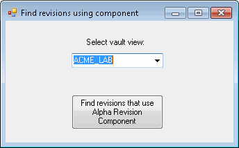

//  9. Replace the code in Form1.cs with this code. // 10. Replace the code in Form1.Designer.cs with this code. // 11. Add dependencies and safely pass arrays of structures. // 12. Open the Immediate window. // 13. Click Debug > Start Debugging or press F5. // // Postconditions:  //  1. Displays a dialog. //  2. Select a vault. //  3. Click the Find revisions that use Alpha Revision Component button. //  4. Prints the names of the revision numbers using the revision number // component Alpha Revision Component to the Immediate window.  //  5. Examine the Immediate window. //  6. Close the dialog. //----------------------------------------------------------------------------

            this.FindRevisionsButton.Text = "Find revisions that use Alpha Revision Component";
            this.FindRevisionsButton.UseVisualStyleBackColor = true;
            this.FindRevisionsButton.Click += new System.EventHandler(this.FindRevisionsButton_Click);
