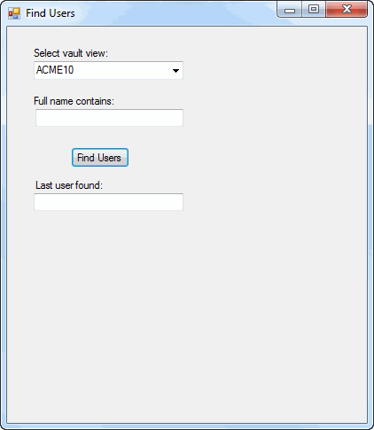

Find Users Example (VB.NET)
This example shows how to find users in the vault.
NOTE: If using the primary interop assembly provided with SOLIDWORKS PDM Professional, see Using .NET Framework 4.0 in Stand-alone Applications.
' Preconditions:
'  1. Start Microsoft Visual Studio.
'  2. Click File > New > Project > Visual Basic, Windows, Desktop > Windows Forms App.
'  3. Type FindUser in Project name.
'  4. For Location, click ... and navigate to the folder where to create the project.
'  5. Click Next.
'  6. Select Framework.
'  7. Click Create.
'  8. Click Show All Files in the Solution Explorer toolbar and expand  '     Form1.vb in the Solution Explorer.
'  9. Replace the code in Form1.vb with this code. ' 10. To create the form, replace the code in Form1.Designer.vb with  '     this code. ' 11. Add dependencies and safely pass arrays of structures. ' 12. Click Debug > Start Debugging or press F5. ' ' Postconditions:  '  1. Displays the Find Users dialog box. '     a. Select a vault view. '     b. In Full name contains, type a substring of the full name of a ' user that exists in the vault. '     c. Click Find Users. ' A message box confirms the substring typed in Postconditions ' step 1b. ' d. Click OK. ' Displays a Search for users dialog. ' e. Click Find. ' Displays a Search for users dialog with results. ' f. Click the first row. ' g. Click Select. ' * Displays a message box with the updated user information. ' * The selected user's phone and website information are updated. ' h. Click OK. ' 2. Updates the Find Users dialog box with the full name and picture, if ' it exists, of the last user found whose full name contains the substring ' typed in Postconditions step 1b. '  3. Close the Find Users dialog box. '---------------------------------------------------------------------------- 'Form1.vb

        Me.Text = "Find Users"
        Me.ResumeLayout(False)
        Me.PerformLayout()
