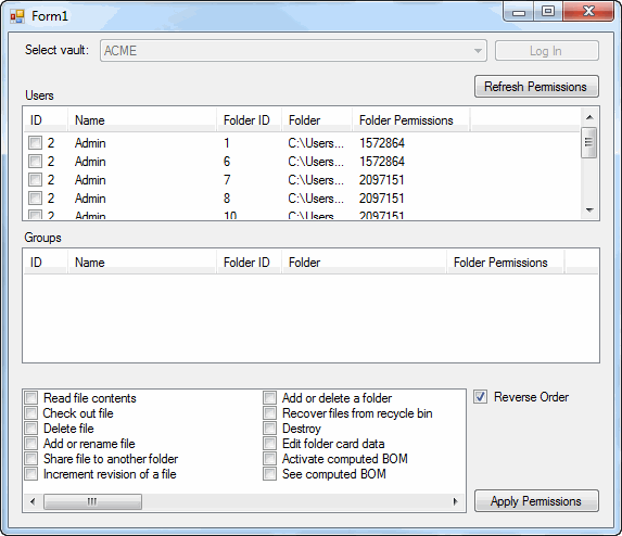

This example shows how to create an application that displays a form in which a user can assign permissions to folders for users and groups in a vault.

' Postconditions:
' 1. In the Form1 dialog, select a vault and click Log In.
'    Wait for the application to populate the Users and Groups list boxes.
' 2. Click permissions in the list box located left of the Reverse Order check box.
' 3. Optionally select the Reverse Order check box.
' 4. Select the check boxes in front of the users and folders to which to assign permissions.
' 5. Click Apply Permissions.
'    Wait for the application to populate the Users list.
'    The folder permissions are updated for the selected users.
' 6. Select the check boxes in front of the groups and folders to which to assign permissions.
' 7. Click Apply Permissions.
'    Wait for the application to populate the Groups list.
'    The folder permissions are updated for the selected groups.

        Me.Label1.AutoSize = True
        Me.Label1.Location = New System.Drawing.Point(12, 9)
        Me.Label1.Name = "Label1"
        Me.Label1.Size = New System.Drawing.Size(66, 13)
        Me.Label1.TabIndex = 0
        Me.Label1.Text = "Select vault:"
        'comboVault
        Me.comboVault.DropDownStyle = System.Windows.Forms.ComboBoxStyle.DropDownList
        Me.comboVault.FormattingEnabled = True
        Me.comboVault.Location = New System.Drawing.Point(84, 6)
        Me.comboVault.Name = "comboVault"
        Me.comboVault.Size = New System.Drawing.Size(357, 21)
        Me.comboVault.TabIndex = 1
        'buttonLogIn
        Me.buttonLogIn.Location = New System.Drawing.Point(447, 6)
        Me.buttonLogIn.Name = "buttonLogIn"
        Me.buttonLogIn.Size = New System.Drawing.Size(98, 21)
        Me.buttonLogIn.TabIndex = 2
        Me.buttonLogIn.Text = "Log In"
        Me.buttonLogIn.UseVisualStyleBackColor = True
        'Label2
        Me.Label2.AutoSize = True
        Me.Label2.Location = New System.Drawing.Point(12, 51)
        Me.Label2.Name = "Label2"
        Me.Label2.Size = New System.Drawing.Size(34, 13)
        Me.Label2.TabIndex = 3
        Me.Label2.Text = "Users"
        'listViewUsers
        Me.listViewUsers.CheckBoxes = True
        Me.listViewUsers.Columns.AddRange(New System.Windows.Forms.ColumnHeader() {Me.ColumnHeader1, Me.ColumnHeader2, Me.ColumnHeader3, Me.ColumnHeader7, Me.ColumnHeader8})
        Me.listViewUsers.Location = New System.Drawing.Point(12, 67)
        Me.listViewUsers.Name = "listViewUsers"
        Me.listViewUsers.Size = New System.Drawing.Size(533, 107)
        Me.listViewUsers.TabIndex = 4
        Me.listViewUsers.UseCompatibleStateImageBehavior = False
        Me.listViewUsers.View = System.Windows.Forms.View.Details
        'ColumnHeader1
        Me.ColumnHeader1.Text = "ID"
        Me.ColumnHeader1.Width = 41
        'ColumnHeader2
        Me.ColumnHeader2.Text = "Name"
        Me.ColumnHeader2.Width = 137
        'ColumnHeader3
        Me.ColumnHeader3.Text = "Folder ID"
        'ColumnHeader7
        Me.ColumnHeader7.Text = "Folder"
        Me.ColumnHeader7.Width = 152
        'ColumnHeader8
        Me.ColumnHeader8.Text = "Folder Permissions"
        Me.ColumnHeader8.Width = 108
        'Label3
        Me.Label3.AutoSize = True
        Me.Label3.Location = New System.Drawing.Point(12, 182)
        Me.Label3.Name = "Label3"
        Me.Label3.Size = New System.Drawing.Size(41, 13)
        Me.Label3.TabIndex = 5
        Me.Label3.Text = "Groups"
        'buttonApply
        Me.buttonApply.Enabled = False
        Me.buttonApply.Location = New System.Drawing.Point(428, 420)
        Me.buttonApply.Name = "buttonApply"
        Me.buttonApply.Size = New System.Drawing.Size(117, 23)
        Me.buttonApply.TabIndex = 7
        Me.buttonApply.Text = "Apply Permissions"
        Me.buttonApply.UseVisualStyleBackColor = True
        'buttonRefresh
        Me.buttonRefresh.Enabled = False
        Me.buttonRefresh.Location = New System.Drawing.Point(428, 38)
        Me.buttonRefresh.Name = "buttonRefresh"
        Me.buttonRefresh.Size = New System.Drawing.Size(117, 23)
        Me.buttonRefresh.TabIndex = 8
        Me.buttonRefresh.Text = "Refresh Permissions"
        Me.buttonRefresh.UseVisualStyleBackColor = True
        'listViewGroups
        Me.listViewGroups.CheckBoxes = True
        Me.listViewGroups.Columns.AddRange(New System.Windows.Forms.ColumnHeader() {Me.ColumnHeader4, Me.ColumnHeader5, Me.ColumnHeader6, Me.ColumnHeader9, Me.ColumnHeader10})
        Me.listViewGroups.Location = New System.Drawing.Point(12, 198)
        Me.listViewGroups.Name = "listViewGroups"
        Me.listViewGroups.Size = New System.Drawing.Size(533, 107)
        Me.listViewGroups.TabIndex = 9
        Me.listViewGroups.UseCompatibleStateImageBehavior = False
        Me.listViewGroups.View = System.Windows.Forms.View.Details
        'ColumnHeader4
        Me.ColumnHeader4.Text = "ID"
        Me.ColumnHeader4.Width = 41
        'ColumnHeader5
        Me.ColumnHeader5.Text = "Name"
        Me.ColumnHeader5.Width = 137
        'ColumnHeader6
        Me.ColumnHeader6.Text = "Folder ID"
        'ColumnHeader9
        Me.ColumnHeader9.Text = "Folder"
        Me.ColumnHeader9.Width = 152
        'ColumnHeader10
        Me.ColumnHeader10.Text = "Folder Permissions"
        Me.ColumnHeader10.Width = 108
        'listViewPermissions
        Me.listViewPermissions.CheckBoxes = True
        Me.listViewPermissions.Location = New System.Drawing.Point(12, 328)
        Me.listViewPermissions.Name = "listViewPermissions"
        Me.listViewPermissions.Size = New System.Drawing.Size(410, 115)
        Me.listViewPermissions.TabIndex = 10
        Me.listViewPermissions.UseCompatibleStateImageBehavior = False
        Me.listViewPermissions.View = System.Windows.Forms.View.List
        'checkboxReverseOrder
        Me.checkboxReverseOrder.AutoSize = True
        Me.checkboxReverseOrder.Location = New System.Drawing.Point(428, 328)
        Me.checkboxReverseOrder.Name = "checkboxReverseOrder"
        Me.checkboxReverseOrder.Size = New System.Drawing.Size(95, 17)
        Me.checkboxReverseOrder.TabIndex = 11
        Me.checkboxReverseOrder.Text = "Reverse Order"
        Me.checkboxReverseOrder.UseVisualStyleBackColor = True
        'Form1
        Me.AutoScaleDimensions = New System.Drawing.SizeF(6.0!, 13.0!)
        Me.AutoScaleMode = System.Windows.Forms.AutoScaleMode.Font
        Me.ClientSize = New System.Drawing.Size(557, 455)
        Me.Controls.Add(Me.checkboxReverseOrder)
        Me.Controls.Add(Me.listViewPermissions)
        Me.Controls.Add(Me.listViewGroups)
        Me.Controls.Add(Me.buttonRefresh)
        Me.Controls.Add(Me.buttonApply)
        Me.Controls.Add(Me.Label3)
        Me.Controls.Add(Me.listViewUsers)
        Me.Controls.Add(Me.Label2)
        Me.Controls.Add(Me.buttonLogIn)
        Me.Controls.Add(Me.comboVault)
        Me.Controls.Add(Me.Label1)
        Me.Name = "Form1"
        Me.Text = "Folder Permissions"
        Me.ResumeLayout(False)
        Me.PerformLayout()
