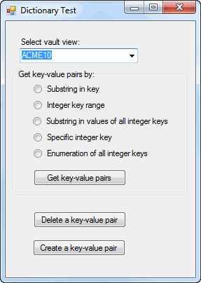

This example shows how to access key-value pairs in a vault dictionary.

' 8. Click Show All Files in the Solution Explorer toolbar and expand
'    Form1.vb in the Solution Explorer. ' 9. Add dependencies and safely pass arrays of structures.
'10. Replace the code in Form1.vb with this code. '11. To create the form, replace the code in Form1.Designer.vb with this code. '12. Click Debug > Start Debugging or press F5. ' ' Postconditions:  '  1. Displays a dialog. '  2. Select a vault view. ' 3. Click Substring in key. ' 4. Click Get key-value pairs. ' a. Displays a message box with all key-value pairs in the dictionary where ' string key contains "at". ' b. Click OK. ' 5. Click Integer key range. ' 6. Click Get key-value pairs. ' a. Displays a message box with all key-value pairs in the dictionary where ' integer keys are in the range, 13-88. ' b. Click OK. ' 7. Click Substring in values of all integer keys. ' 8. Click Get key-value pairs. ' a. Displays a message box with all key-value pairs in the dictionary where ' value contains "three". ' b. Click OK. ' 9. Click Specific integer key. ' 10. Click Get key-value pairs. ' a. Displays a message box with the value for key, 77. ' b. Click OK. ' 11. Click Enumeration of all integer keys. ' 12. Click Get key-value pairs. ' a. Displays a message box with all integer key-value pairs in the dictionary. ' b. Click OK. ' 13. Click Delete a key-value pair. ' a. Displays a message box notifying that key, 2, is removed. ' b. Click OK. ' 14. Click Create a key-value pair. ' a. Displays a message box notifying that key, 2, is created. ' b. Click OK. ' 15. Close the dialog. '---------------------------------------------------------------------------- 'Form1.vb

        Me.VaultsComboBox = New System.Windows.Forms.ComboBox()
        Me.Label1 = New System.Windows.Forms.Label()
        Me.Button5 = New System.Windows.Forms.Button()
        Me.Button7 = New System.Windows.Forms.Button()
        Me.RadioButton1 = New System.Windows.Forms.RadioButton()
        Me.RadioButton2 = New System.Windows.Forms.RadioButton()
        Me.RadioButton3 = New System.Windows.Forms.RadioButton()
        Me.RadioButton4 = New System.Windows.Forms.RadioButton()
        Me.RadioButton5 = New System.Windows.Forms.RadioButton()
        Me.Button1 = New System.Windows.Forms.Button()
        Me.GroupBox1 = New System.Windows.Forms.GroupBox()
        Me.GroupBox1.SuspendLayout()
        Me.SuspendLayout()
        'VaultsComboBox
        Me.VaultsComboBox.FormattingEnabled = True
        Me.VaultsComboBox.Location = New System.Drawing.Point(20, 39)
        Me.VaultsComboBox.Name = "VaultsComboBox"
        Me.VaultsComboBox.Size = New System.Drawing.Size(169, 21)
        Me.VaultsComboBox.TabIndex = 1
        'Label1
        Me.Label1.AutoSize = True
        Me.Label1.Location = New System.Drawing.Point(19, 23)
        Me.Label1.Name = "Label1"
        Me.Label1.Size = New System.Drawing.Size(91, 13)
        Me.Label1.TabIndex = 2
        Me.Label1.Text = "Select vault view:"
        'Button5
        Me.Button5.Location = New System.Drawing.Point(40, 272)
        Me.Button5.Name = "Button5"
        Me.Button5.Size = New System.Drawing.Size(132, 23)
        Me.Button5.TabIndex = 7
        Me.Button5.Text = "Delete a key-value pair"
        Me.Button5.UseVisualStyleBackColor = True
        'Button7
        Me.Button7.Location = New System.Drawing.Point(39, 312)
        Me.Button7.Name = "Button7"
        Me.Button7.Size = New System.Drawing.Size(132, 23)
        Me.Button7.TabIndex = 9
        Me.Button7.Text = "Create a key-value pair"
        Me.Button7.UseVisualStyleBackColor = True
        'RadioButton1
        Me.RadioButton1.AutoSize = True
        Me.RadioButton1.Location = New System.Drawing.Point(30, 19)
        Me.RadioButton1.Name = "RadioButton1"
        Me.RadioButton1.Size = New System.Drawing.Size(100, 17)
        Me.RadioButton1.TabIndex = 11
        Me.RadioButton1.Text = "Substring in key"
        Me.RadioButton1.UseVisualStyleBackColor = True
        'RadioButton2
        Me.RadioButton2.AutoSize = True
        Me.RadioButton2.Location = New System.Drawing.Point(30, 42)
        Me.RadioButton2.Name = "RadioButton2"
        Me.RadioButton2.Size = New System.Drawing.Size(108, 17)
        Me.RadioButton2.TabIndex = 12
        Me.RadioButton2.TabStop = True
        Me.RadioButton2.Text = "Integer key range"
        Me.RadioButton2.UseVisualStyleBackColor = True
        'RadioButton3
        Me.RadioButton3.AutoSize = True
        Me.RadioButton3.Location = New System.Drawing.Point(29, 65)
        Me.RadioButton3.Name = "RadioButton3"
        Me.RadioButton3.Size = New System.Drawing.Size(199, 17)
        Me.RadioButton3.TabIndex = 13
        Me.RadioButton3.TabStop = True
        Me.RadioButton3.Text = "Substring in values of all integer keys"
        Me.RadioButton3.UseVisualStyleBackColor = True
        'RadioButton4
        Me.RadioButton4.AutoSize = True
        Me.RadioButton4.Location = New System.Drawing.Point(30, 88)
        Me.RadioButton4.Name = "RadioButton4"
        Me.RadioButton4.Size = New System.Drawing.Size(118, 17)
        Me.RadioButton4.TabIndex = 14
        Me.RadioButton4.TabStop = True
        Me.RadioButton4.Text = "Specific integer key"
        Me.RadioButton4.UseVisualStyleBackColor = True
        'RadioButton5
        Me.RadioButton5.AutoSize = True
        Me.RadioButton5.Location = New System.Drawing.Point(30, 111)
        Me.RadioButton5.Name = "RadioButton5"
        Me.RadioButton5.Size = New System.Drawing.Size(169, 17)
        Me.RadioButton5.TabIndex = 15
        Me.RadioButton5.TabStop = True
        Me.RadioButton5.Text = "Enumeration of all integer keys"
        Me.RadioButton5.UseVisualStyleBackColor = True
        'Button1
        Me.Button1.Location = New System.Drawing.Point(30, 143)
        Me.Button1.Name = "Button1"
        Me.Button1.Size = New System.Drawing.Size(132, 23)
        Me.Button1.TabIndex = 16
        Me.Button1.Text = "Get key-value pairs"
        Me.Button1.UseVisualStyleBackColor = True
        'GroupBox1
        Me.GroupBox1.Controls.Add(Me.Button1)
        Me.GroupBox1.Controls.Add(Me.RadioButton5)
        Me.GroupBox1.Controls.Add(Me.RadioButton4)
        Me.GroupBox1.Controls.Add(Me.RadioButton3)
        Me.GroupBox1.Controls.Add(Me.RadioButton2)
        Me.GroupBox1.Controls.Add(Me.RadioButton1)
        Me.GroupBox1.Location = New System.Drawing.Point(10, 69)
        Me.GroupBox1.Name = "GroupBox1"
        Me.GroupBox1.Size = New System.Drawing.Size(249, 181)
        Me.GroupBox1.TabIndex = 17
        Me.GroupBox1.TabStop = False
        Me.GroupBox1.Text = "Get key-value pairs by:"
        'Form1
        Me.AutoScaleDimensions = New System.Drawing.SizeF(6.0!, 13.0!)
        Me.AutoScaleMode = System.Windows.Forms.AutoScaleMode.Font
        Me.ClientSize = New System.Drawing.Size(271, 366)
        Me.Controls.Add(Me.GroupBox1)
        Me.Controls.Add(Me.Button7)
        Me.Controls.Add(Me.Button5)
        Me.Controls.Add(Me.Label1)
        Me.Controls.Add(Me.VaultsComboBox)
        Me.Name = "Form1"
        Me.Text = "Dictionary Test"
        Me.GroupBox1.ResumeLayout(False)
        Me.GroupBox1.PerformLayout()
        Me.ResumeLayout(False)
        Me.PerformLayout()
