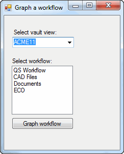

// 1. Displays the Graph a workflow dialog box.
// 2. Maximize the dialog box for the workflow graph.
// 3. Select a vault view.
// 4. Click a workflow.
// 5. Click Graph workflow
// 6. Graphs the selected workflow in the dialog box.

            this.Text = "Graph a workflow";
