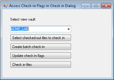

Prevent Admin from Checking In File Example (C#)
This example shows how to prevent Admin from checking in a file that was not checked out by Admin.
NOTE: If using the primary interop assembly provided with SOLIDWORKS PDM Professional, see Using .NET Framework 4.0 in Stand-alone Applications.
// Preconditions:
// 1. Start Microsoft Visual Studio.
// 2. Click File > New > Project > C#,
Windows, Desktop > Windows Forms App.
// 3. Type RefItemContainerCSharp in Project name.
// 4. For Location, click ... and navigate to the folder where to create the project.
// 5. Click Next
// 6. Select Framework.
// 7. Click Create.
// 8. Click Show All Files in the Solution Explorer toolbar and expand
//    Form1.cs in the Solution Explorer.
// 9. Add dependencies and safely pass arrays of structures.
//10. Replace the code in Form1.cs with this code. //11. To create the form, replace the code in Form1.Designer.cs with  //    this code. //12. To create the class for the callback: //        1. Right-click RefItemContainerCSharp in the Solution Explorer. //        2. Click Add > Class. //        3. Type Callback.cs in Name and click Add. //        4. Replace the code in Callback.cs with this code. //13. Ensure that a file in the targeted vault is checked out by a user  //    other than Admin. //14. Log into the targeted vault as Admin. //15. Click Debug > Start Debugging or press F5. // // Postconditions:  // 1. Displays the Access Check-in Flags in Check in Dialog dialog box. // 2. Select the vault view where you are logged in as Admin. // 3. Click Select checked-out files to check in. //    a. Displays the Select files dialog box. //    b. Select the file verified as checked out by a user other than  //       Admin. //    c. Click Open. // 4. Click Create batch check-in //    a. Displays message boxes with callback information. //    b. Click OK to close each message box. //    c. Displays a message box verifying that the batch check-in  //       was created.  //    d. Click OK to close the message box. // 5. Click Update check-in flags. //    a. Displays a message box verifying that check-in flags were updated. //    b. Click OK to close the message box. // 6. Click Check in files. //    a. Displays the Check in dialog box. //    b. Select the Check in check box. //    c. Click the Check in button. //    d. Displays message boxes with callback information. //    e. Click OK to close each message box. //    f. Displays an error message informing you that the file is not //       checked out by Admin.  //    g. Click OK to close the error message. // 7. Open a File Explorer view of the selected vault and verify that the  //    file that you selected to check in is still checked out. // 8. Close the Access Check-in Flags in Check in Dialog dialog box. //--------------------------------------------------------------------------------------

        private void BrowseButton_Click(object sender, EventArgs e)
            try
                //Only create a new vault object
                //if one hasn't been created yet
                if (vault1 == null)
                    vault1 = new EdmVault5();
                if (!vault1.IsLoggedIn)
                    //Log into selected vault as the current user
                    vault1.LoginAuto(VaultsComboBox.Text, this.Handle.ToInt32());
                //Display the Select file dialog for user to
                //select the files
                EdmStrLst5 pathList = default(EdmStrLst5);
                pathList = vault.BrowseForFile(this.Handle.ToInt32(),
		(int)EdmBrowseFlag.EdmBws_ForOpen + (int)EdmBrowseFlag.EdmBws_PermitMultipleSel +
		(int)EdmBrowseFlag.EdmBws_PermitVaultFiles, "SOLIDWORKS files " +
		"(*.sldprt; *.sldasm; *.slddrw)|" + "*.sldprt;*.sldasm;*.slddrw|" + "All Files (*.*)|*.*||"""
		"", vault.RootFolderPath"Select files");

        private void CreateBatchCheckinButton_Click(object sender, EventArgs e)
            try
                if (vault1 == null)
                IEdmVault7 vault2 = (IEdmVault7)vault1;
                bUnlock = (IEdmBatchUnlock)vault2.CreateUtility(EdmUtility.EdmUtil_BatchUnlock);
                bUnlock.AddSelection((EdmVault5)vault1, ref selFiles);
                bool tree = false;
	       Callback myCallback = new Callback();
                tree = bUnlock.CreateTree(this.Handle.ToInt32(), (int)EdmUnlockBuildTreeFlags.Eubtf_MayUnlock, myCallback);
                if (tree == false)
                    MessageBox.Show("No checked-out files selected to check in. Please try again.");
                    return;
                MessageBox.Show("Batch check-in created.");

        private void UpdateBatchCheckInButton_Click(object sender, EventArgs e)
             try
                if (vault1 == null)
                   IEdmRefItemContainer container = null;
                   if (bUnlock == null)
                        return;
                    else
                    container = (IEdmRefItemContainer)bUnlock;
                    object[] items = null;
                    IEdmRefItem theItem = null;
                    container.GetItems(EdmRefItemType.Edmrit_All, out items);
                    int j = 0;
                    while (j < items.Length)
                        IEdmRefItem aItem = null;
                        theItem = (IEdmRefItem)items[j];
                        aItem = theItem;
                        object value = null;
                        aItem.SetProperty(EdmRefItemProperty.Edmrip_CheckKeepLocked, value);
                        j = j + 1;
                    MessageBox.Show("Check-in flags updated.");

        private void CheckInButton_Click(object sender, EventArgs e)
            try
                if (vault1 == null)
                    return;
                else
                if (bUnlock.ShowDlg(this.Handle.ToInt32()))
                    bUnlock.UnlockFiles(this.Handle.ToInt32(), myCallback);

            this.Controls.Add(this.CreateBatchCheckinButton);
            this.Controls.Add(this.VaultsComboBox);
            this.Controls.Add(this.VaultsLabel);
            this.Name = "Form1";
            this.Text = "Access Check-in Flags in Check in Dialog";
            this.Load += new System.EventHandler(this.Form1_Load);
            this.ResumeLayout(false);
            this.PerformLayout();
        #endregion
        private System.Windows.Forms.Label VaultsLabel;
        private System.Windows.Forms.ComboBox VaultsComboBox;
        private System.Windows.Forms.Button CreateBatchCheckinButton;
        private System.Windows.Forms.Button UpdateBatchCheckInButton;
        private System.Windows.Forms.Button CheckInButton;
        private System.Windows.Forms.Button BrowseButton;
