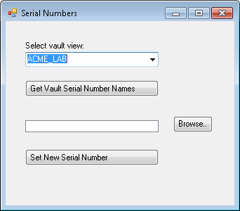

Set Part Numbers Using Default Serial Numbers Example (C#)
This example shows how to set part numbers using default serial numbers.

//Form1.Designer.cs
namespace SerialNumbersCSharp
	partial class Form1
		/// <summary>
		/// Required designer variable.
		/// </summary>
		private System.ComponentModel.IContainer components = null;
		/// <summary>
		/// Clean up any resources being used.
		/// </summary>
		/// <param name="disposing">true if managed resources should be disposed; otherwise, false.</param>
		protected override void Dispose(bool disposing)
			if (disposing && (components != null))
				components.Dispose();
			base.Dispose(disposing);
		#region Windows Form Designer generated code
		/// <summary>
		/// Required method for Designer support - do not modify
		/// the contents of this method with the code editor.
		/// </summary>
		private void InitializeComponent()
			this.VaultsLabel = new System.Windows.Forms.Label();
			this.VaultsComboBox = new System.Windows.Forms.ComboBox();
			this.Button1 = new System.Windows.Forms.Button();
			this.FileListBox = new System.Windows.Forms.ListBox();
			this.OpenFileDialog1 = new System.Windows.Forms.OpenFileDialog();
			this.BrowseButton = new System.Windows.Forms.Button();
			this.NewButton = new System.Windows.Forms.Button();
			this.SuspendLayout();
			//VaultsLabel
			this.VaultsLabel.AutoSize = true;
			this.VaultsLabel.ImageAlign = System.Drawing.ContentAlignment.MiddleLeft;
			this.VaultsLabel.Location = new System.Drawing.Point(25, 28);
			this.VaultsLabel.Name = "VaultsLabel";
			this.VaultsLabel.Size = new System.Drawing.Size(91, 13);
			this.VaultsLabel.TabIndex = 0;
			this.VaultsLabel.Text = "Select vault view:";
			//VaultsComboBox
			this.VaultsComboBox.FormattingEnabled = true;
			this.VaultsComboBox.Location = new System.Drawing.Point(28, 44);
			this.VaultsComboBox.Name = "VaultsComboBox";
			this.VaultsComboBox.Size = new System.Drawing.Size(190, 21);
			this.VaultsComboBox.TabIndex = 1;
			//Button1
			this.Button1.ImageAlign = System.Drawing.ContentAlignment.MiddleLeft;
			this.Button1.Location = new System.Drawing.Point(28, 84);
			this.Button1.Name = "Button1";
			this.Button1.Size = new System.Drawing.Size(190, 23);
			this.Button1.TabIndex = 2;
			this.Button1.Text = "Get Vault Serial Number Names";
			this.Button1.TextAlign = System.Drawing.ContentAlignment.MiddleLeft;
			this.Button1.UseVisualStyleBackColor = true;
            		this.Button1.Click += new System.EventHandler(this.Button1_Click);
			//FileListBox
			this.FileListBox.FormattingEnabled = true;
			this.FileListBox.Location = new System.Drawing.Point(28, 141);
			this.FileListBox.Name = "FileListBox";
			this.FileListBox.Size = new System.Drawing.Size(190, 17);
			this.FileListBox.TabIndex = 3;
			//OpenFileDialog1
			this.OpenFileDialog1.FileName = "OpenFileDialog1";
			this.OpenFileDialog1.Multiselect = true;
			this.OpenFileDialog1.Title = "Select a file";
			//BrowseButton
			this.BrowseButton.Location = new System.Drawing.Point(239, 135);
			this.BrowseButton.Name = "BrowseButton";
			this.BrowseButton.Size = new System.Drawing.Size(56, 23);
			this.BrowseButton.TabIndex = 4;
			this.BrowseButton.Text = "Browse...";
			this.BrowseButton.TextAlign = System.Drawing.ContentAlignment.MiddleLeft;
			this.BrowseButton.UseVisualStyleBackColor = true;
            		this.BrowseButton.Click += new System.EventHandler(this.BrowseButton_Click);
			//NewButton
			this.NewButton.Location = new System.Drawing.Point(28, 182);
			this.NewButton.Name = "NewButton";
			this.NewButton.Size = new System.Drawing.Size(190, 23);
			this.NewButton.TabIndex = 5;
			this.NewButton.Text = "Set New Serial Number";
			this.NewButton.TextAlign = System.Drawing.ContentAlignment.MiddleLeft;
			this.NewButton.UseVisualStyleBackColor = true;
            		this.NewButton.Click += new System.EventHandler(this.NewButton_Click);
			//Form1
			this.AutoScaleDimensions = new System.Drawing.SizeF(6f, 13f);
			this.AutoScaleMode = System.Windows.Forms.AutoScaleMode.Font;
			this.ClientSize = new System.Drawing.Size(326, 262);
			this.Controls.Add(this.NewButton);
			this.Controls.Add(this.BrowseButton);
			this.Controls.Add(this.FileListBox);
			this.Controls.Add(this.Button1);
			this.Controls.Add(this.VaultsComboBox);
			this.Controls.Add(this.VaultsLabel);
			this.Name = "Form1";
			this.Text = "Serial Numbers";
            		this.Load += new System.EventHandler(this.Form1_Load);
			this.ResumeLayout(false);
			this.PerformLayout();
	#endregion
	internal System.Windows.Forms.Label VaultsLabel;
	internal System.Windows.Forms.ComboBox VaultsComboBox;
	internal System.Windows.Forms.Button Button1;
	internal System.Windows.Forms.ListBox FileListBox;
	internal System.Windows.Forms.Button BrowseButton;
	internal System.Windows.Forms.Button NewButton;
	internal System.Windows.Forms.OpenFileDialog OpenFileDialog1;
