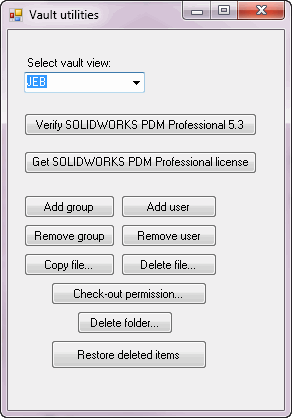

This example shows how to:
  • Verify installed SOLIDWORKS PDM Professional version is at least 5.3.
  • Get installed SOLIDWORKS PDM Professional licenses.
  • Add a group.
  • Remove a group.
  • Add a user.
  • Remove a user.
  • Copy a file.
  • Delete a file.
  • Get check-out permission for a file.
  • Delete a folder.
  • Restore deleted items to the vault view.

' 1. Displays the Vault utilities dialog box.
'    a. Select a vault view.
'    b. Click Verify SOLIDWORKS PDM Professional 5.3
'       1. Displays message about the installed version.
'       2. Click OK.
'    c. Click Get SOLIDWORKS Professional PDM licenses.
'       1. Displays a message with the installed licenses.
'       2. Click OK.
'    d. Click Add group.
'       1. Displays a message that group, My Group, is created.
'       2. Click OK.
'    e. Click Add user.
'       1. Displays a message that user, Temp, is created.
'       2. Click OK.
'    f. Click Remove group.
'       1. Displays a message with the removal status.
'       2. Click OK.
'    g. Click Remove user.
'       2. Click OK.
'    h. Click Copy file.
'       1. In the Open dialog, click a vault file.
'       2. Click Open.
'       3. In the Select Folder dialog, click a folder to which to copy
'          the selected file.
'       4. Click OK.
'       5. Displays a message with the file copy status.
'       6. Click OK.
'    i. Click Delete file.
'       1. In the Select Files to Delete dialog box, click a vault file
'          to delete.
'       2. Click Open.
'       3. Displays a message with the file deletion status.
'       4. Click OK.
'    j. Click Check-out permission.
'       1. In the Open dialog, click a file for which to get the check-out
'          permission.
'       2. Click Open.
'       3. Displays a message with the user's permission.
'       4. Click OK.
'    k. Click Delete folder.
'       1. In the Select Folder dialog, click an empty vault folder to delete.
'       2. Click OK.
'       3. Displays a message with the status of the folder deletion.
'       4. Click OK.
'    l. Click Restore deleted items.
'       1. In the Select Folder dialog, click the folder from which you deleted
'          a file in step 1i.
'       2. Click OK.
'       3. Displays a message with the status of the folder restoration.
'       4. Click OK.

'Form1.Designer.vb
<Global.Microsoft.VisualBasic.CompilerServices.DesignerGenerated()> _
Partial Class Form1
    Inherits System.Windows.Forms.Form
    ''' <summary>
    ''' Required designer variable.
    ''' </summary>
    Private components As System.ComponentModel.IContainer = Nothing
    ''' <summary>
    ''' Clean up any resources being used.
    ''' </summary>
    ''' <param name="disposing">true if managed resources should be disposed; otherwise, false.</param>
    Protected Overrides Sub Dispose(ByVal disposing As Boolean)
        If disposing AndAlso (components IsNot NothingThen
            components.Dispose()
        End If
        MyBase.Dispose(disposing)
    End Sub
#Region "Windows Form Designer generated code"
    ''' <summary>
    ''' Required method for Designer support - do not modify
    ''' the contents of this method with the code editor.
    ''' </summary>
    Private Sub InitializeComponent()
        Me.VaultsLabel = New System.Windows.Forms.Label()
        Me.VaultsComboBox = New System.Windows.Forms.ComboBox()
        Me.Button1 = New System.Windows.Forms.Button()
        Me.Button2 = New System.Windows.Forms.Button()
        Me.Button3 = New System.Windows.Forms.Button()
        Me.Button4 = New System.Windows.Forms.Button()
        Me.Button5 = New System.Windows.Forms.Button()
        Me.Button6 = New System.Windows.Forms.Button()
        Me.Button7 = New System.Windows.Forms.Button()
        Me.Button8 = New System.Windows.Forms.Button()
        Me.Button9 = New System.Windows.Forms.Button()
        Me.Button10 = New System.Windows.Forms.Button()
        Me.Button11 = New System.Windows.Forms.Button()
        Me.OpenFileDialog1 = New System.Windows.Forms.OpenFileDialog()
        Me.SuspendLayout()
        'VaultsLabel
        Me.VaultsLabel.AutoSize = True
        Me.VaultsLabel.Location = New System.Drawing.Point(13, 26)
        Me.VaultsLabel.Name = "VaultsLabel"
        Me.VaultsLabel.Size = New System.Drawing.Size(94, 13)
        Me.VaultsLabel.TabIndex = 0
        Me.VaultsLabel.Text = " Select vault view:"
        'VaultsComboBox
        Me.VaultsComboBox.FormattingEnabled = True
        Me.VaultsComboBox.Location = New System.Drawing.Point(16, 42)
        Me.VaultsComboBox.Name = "VaultsComboBox"
        Me.VaultsComboBox.Size = New System.Drawing.Size(121, 21)
        Me.VaultsComboBox.TabIndex = 1
        'Button1
        Me.Button1.Location = New System.Drawing.Point(16, 223)
        Me.Button1.Name = "Button1"
        Me.Button1.Size = New System.Drawing.Size(91, 23)
        Me.Button1.TabIndex = 6
        Me.Button1.Text = "Copy file..."
        Me.Button1.UseVisualStyleBackColor = True
        'Button2
        Me.Button2.Location = New System.Drawing.Point(113, 223)
        Me.Button2.Name = "Button2"
        Me.Button2.Size = New System.Drawing.Size(96, 23)
        Me.Button2.TabIndex = 7
        Me.Button2.Text = "Delete file..."
        Me.Button2.UseVisualStyleBackColor = True
        'Button3
        Me.Button3.Location = New System.Drawing.Point(69, 281)
        Me.Button3.Name = "Button3"
        Me.Button3.Size = New System.Drawing.Size(96, 23)
        Me.Button3.TabIndex = 8
        Me.Button3.Text = "Delete folder..."
        Me.Button3.UseVisualStyleBackColor = True
        'Button4
        Me.Button4.Location = New System.Drawing.Point(43, 252)
        Me.Button4.Name = "Button4"
        Me.Button4.Size = New System.Drawing.Size(156, 23)
        Me.Button4.TabIndex = 9
        Me.Button4.Text = "Check-out permission..."
        Me.Button4.UseVisualStyleBackColor = True
        'Button5
        Me.Button5.Location = New System.Drawing.Point(16, 83)
        Me.Button5.Name = "Button5"
        Me.Button5.Size = New System.Drawing.Size(233, 23)
        Me.Button5.TabIndex = 10
        Me.Button5.Text = "Verify SOLIDWORKS PDM Professional 5.3"
        Me.Button5.UseVisualStyleBackColor = True
        'Button6
        Me.Button6.Location = New System.Drawing.Point(16, 121)
        Me.Button6.Name = "Button6"
        Me.Button6.Size = New System.Drawing.Size(233, 23)
        Me.Button6.TabIndex = 11
        Me.Button6.Text = "Get SOLIDWORKS PDM Professional licenses"
        Me.Button6.UseVisualStyleBackColor = True
        'Button7
        Me.Button7.Location = New System.Drawing.Point(16, 165)
        Me.Button7.Name = "Button7"
        Me.Button7.Size = New System.Drawing.Size(91, 23)
        Me.Button7.TabIndex = 12
        Me.Button7.Text = "Add group"
        Me.Button7.UseVisualStyleBackColor = True
        'Button8
        Me.Button8.Location = New System.Drawing.Point(16, 194)
        Me.Button8.Name = "Button8"
        Me.Button8.Size = New System.Drawing.Size(91, 23)
        Me.Button8.TabIndex = 13
        Me.Button8.Text = "Remove group"
        Me.Button8.UseVisualStyleBackColor = True
        'Button9
        Me.Button9.Location = New System.Drawing.Point(113, 165)
        Me.Button9.Name = "Button9"
        Me.Button9.Size = New System.Drawing.Size(96, 23)
        Me.Button9.TabIndex = 14
        Me.Button9.Text = "Add user"
        Me.Button9.UseVisualStyleBackColor = True
        'Button10
        Me.Button10.Location = New System.Drawing.Point(113, 194)
        Me.Button10.Name = "Button10"
        Me.Button10.Size = New System.Drawing.Size(96, 23)
        Me.Button10.TabIndex = 15
        Me.Button10.Text = "Remove user"
        Me.Button10.UseVisualStyleBackColor = True
        'Button11
        Me.Button11.Location = New System.Drawing.Point(43, 310)
        Me.Button11.Name = "Button11"
        Me.Button11.Size = New System.Drawing.Size(156, 29)
        Me.Button11.TabIndex = 16
        Me.Button11.Text = "Restore deleted items"
        Me.Button11.UseVisualStyleBackColor = True
        'OpenFileDialog1
        Me.OpenFileDialog1.FileName = "OpenFileDialog1"
        'Form1
        Me.AutoScaleDimensions = New System.Drawing.SizeF(6.0!, 13.0!)
        Me.AutoScaleMode = System.Windows.Forms.AutoScaleMode.Font
        Me.ClientSize = New System.Drawing.Size(276, 330)
        Me.Controls.Add(Me.Button11)
        Me.Controls.Add(Me.Button10)
        Me.Controls.Add(Me.Button9)
        Me.Controls.Add(Me.Button8)
        Me.Controls.Add(Me.Button7)
        Me.Controls.Add(Me.Button6)
        Me.Controls.Add(Me.Button5)
        Me.Controls.Add(Me.Button4)
        Me.Controls.Add(Me.Button3)
        Me.Controls.Add(Me.Button2)
        Me.Controls.Add(Me.Button1)
        Me.Controls.Add(Me.VaultsComboBox)
        Me.Controls.Add(Me.VaultsLabel)
        Me.Name = "Form1"
        Me.Text = "Vault utilities"
        Me.ResumeLayout(False)
        Me.PerformLayout()
    End Sub
#End Region
    Friend WithEvents VaultsLabel As System.Windows.Forms.Label
    Friend WithEvents VaultsComboBox As System.Windows.Forms.ComboBox
    Friend WithEvents Button1 As System.Windows.Forms.Button
    Friend WithEvents Button2 As System.Windows.Forms.Button
    Friend WithEvents Button3 As System.Windows.Forms.Button
    Friend WithEvents Button4 As System.Windows.Forms.Button
    Friend WithEvents Button5 As System.Windows.Forms.Button
    Friend WithEvents Button6 As System.Windows.Forms.Button
    Friend WithEvents Button7 As System.Windows.Forms.Button
    Friend WithEvents Button8 As System.Windows.Forms.Button
    Friend WithEvents Button9 As System.Windows.Forms.Button
    Friend WithEvents Button10 As System.Windows.Forms.Button
    Friend WithEvents Button11 As System.Windows.Forms.Button
    Friend WithEvents OpenFileDialog1 As System.Windows.Forms.OpenFileDialog
End Class
Back to top
