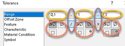

Range
A Tolerance options dialog above appears when a tolerance symbol is selected in the Tolerance dialog and the Gtol is placed in the graphics area. The Range information in the picture above maps to XML node <ToleranceRangeInfo> and its sub-nodes.
The ovals are numbered and colored in a top to bottom, left to right fashion as follows: 1 (yellow), 2 (red), 3 (purple), 4 (yellow), 5 (red), 6 (purple), 7 (yellow), 8 (red).
Yellow oval 1 maps to XML node <PrimaryToleranceValue> which has a numerical value.
Red oval 2 maps to XML node <PrimaryRangeSymbol>, with possible values sPhi (for spherical diameter), phi (diameter), sqr (square), or empty for none.
Purple oval 3 maps to XML node <ConjunctionSymbol1>, with possible values -,  /, or empty for neither.
Yellow oval 4 maps to XML node <ToleranceZone> which has a numerical value.
Red oval 5 maps to XML node <ToleranceZoneSymbol>, with possible values sPhi (for spherical diameter), phi (diameter), sqr (square), deg (degree), or empty for none.
Purple oval 6 maps to XML node <ConjunctionSymbol2> with values - or  X (no empty value option here).
Yellow oval 7 maps to XML node <RestrictedToleranceZoneLimit> has a numerical value.
Red oval 8 maps to XML node <RestrictedToleranceZoneLimitSymbol> with possible values sPhi (for spherical diameter), phi (diameter), sqr (square), deg (degree), or empty for none.
Apply Max Tolerance control maps to XML node <ApplyMAXTolerance> with possible values true or false. If Apply Max Tolerance is selected in the dialog, the max tolerance symbol and value controls are enabled.
Max tolerance symbol control maps to XML node <MaxToleranceSymbol> with possible value of phi (diameter).
Max tolerance value control maps to XML node <MaxToleranceValue> with possible numerical values.

                                <ConjunctionSymbol2>-</ConjunctionSymbol2>
                                <RestrictedToleranceZoneLimit>0.03</RestrictedToleranceZoneLimit>
                                <RestrictedToleranceZoneLimitSymbol>deg</RestrictedToleranceZoneLimitSymbol>
                </ToleranceRangeInfo>
The second frame has Range XML string:
                                <PrimaryToleranceValue>0.02</PrimaryToleranceValue>
                                <PrimaryRangeSymbol></PrimaryRangeSymbol>

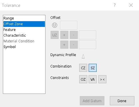

Offset Zone
A Tolerance options dialog above appears when a tolerance symbol is selected in the Tolerance dialog and the Gtol is placed in the graphics area. The Offset Zone information in the picture above maps to XML node <OffsetZoneInfo> and its sub-nodes.
In the first row, the circle-U control maps to Gtol XML node <UnequallyDisposedProfile >. Setting its value to true is analogous to clicking that control. The edit field control next to circle-U maps to Gtol XML node <OutsideDeposition> which takes a numerical value.
The UZ control in the second row maps to Gtol XML node <ToleranceZoneOffset>. Setting its value to true is analogous to clicking that control.
The +/- controls next to UZ map to Gtol XML nodes <OutsideFirstZoneOffset> and <InsideFirstZoneOffset>. Setting each to true is analogous to clicking those controls. The last edit value field on the UZ line maps to Gtol XML node <FirstOffset> which takes  a numerical value.
The next line’s +/- controls map to Gtol XML nodes <OutsideSecondZoneOffset> and <InsideSecondZoneOffset>. Set each to true to click those controls. The last edit value field on the line maps to Gtol XML node <SecondOffset> which takes a numerical value.
<UnequallyDisposedProfile> and <ToleranceZoneOffset> are mutually exclusive.
The Dynamic Profile control maps to Gtol XML node <DynamicProfile> with possible values, true or false.
The Combination controls map to Gtol XML node <Combination> with possible values CZ or SZ, but not both.
The Constraint controls (OZ (Offset Tolerance Zone), VA (Unspecified Angular Tolerance Zone Offset Specification Element), >< (Orientation-only Specification Element)) map to Gtol XML node <Constraint> with possible values OffsetToleranceZone / UnspecifiedAngularToleranceZoneOffset / OrientationOnly. Specify one, two, or all three.
 Gtol  has the following Offset Zone XML string:
<OffsetZoneInfo>
<Constraint>OffsetToleranceZone</Constraint>
<Constraint>OrientationOnly</Constraint>
</OffsetZoneInfo>

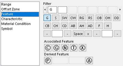

Feature
A Tolerance options dialog above appears when a tolerance symbol is selected in the Tolerance dialog and the Gtol is placed in the graphics area. The Feature information in the picture above maps to XML node <FeatureInfo> and its sub-nodes.
The top four rows define multiple filters. The filter types are listed in the second and third rows. Each filter type has associated information in the fourth row.
The information about a filter type (as shown in an edit box in the top row) maps to Gtol XML node <FilterDetail>. Since there could be many <FilterDetail> elements, <Filters> contains an array of <FilterDetail>.
The 17 controls in the second and third rows of the dialog map to Gtol XML node <FilterSymbol>.
There are seven controls in the fourth row of the dialog. The first three controls correspond to the first cutoff value, with possible short/long wave dashes around it. The middle control is a separator value that can be a space or an X. The last three controls correspond to the second cutoff value, with possible short/long wave dashes around it.
The fourth row of controls in the Gtol,  map (from left to right) to the following Gtol XML nodes:
                <ShortWavePassFilter> true/false, analogous to setting/unsetting the first dash
                <CutOff> numerical value
                <LongWavePassFilter> true/false, analogous to setting/unsetting the second dash
                <FilterIndicationSeparator> Three possible values: space, "X", or empty. If empty, no space or X is added between cutoff and cutoff2 strings
                <ShortWavePassFilter2> true/false, analogous to setting/unsetting the first dash
                <CutOff2> numerical value
                <LongWavePassFilter2> true/false, analogous to setting/unsetting the second dash
Gtol has two filters of type AB and CD. “AB-2” is filter 1 and “CD-3x-4” is filter 2. The filter portion of its XML string:

The row of Associated Feature controls map to Gtol XML node <AssociatedFeatureInfo>. This node has five possible mutually exclusive string values (corresponding to the five controls from left to right) “Minimax / LeastSquares / MinimumCircumscribed / Tangent / MaximumInscribed”.
<AssociatedFeatureInfo></AssociatedFeatureInfo> is analogous to de-selecting all five controls.
The 4 controls in the last row,  map to the following Gtol XML nodes:
              <ProjectedToleranceZone> true/false, analogous to clicking/unclicking the  control
             <Projection> numerical value
             <ProjectionRange> numerical value
             <DerivedFeatureForFeatureOfSize> true/false, analogous to clicking/unclicking the  control

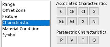

Characteristic
A Tolerance options dialog above appears when a tolerance symbol is selected in the Tolerance dialog and the Gtol is placed in the graphics area. The Characteristic information in the picture above maps to Gtol XML nodes:
                <AssociatedCharacteristic> has mutually exclusive values, C, CE, CI, G, GE, GI, X, N, or empty
                <ParametricCharacteristic> has mutually exclusive values, P, V, T, Q, or empty

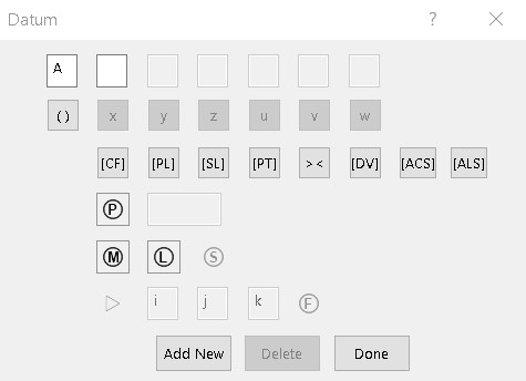

Datum dialog
The Datum dialog above appears when you click Add Datum in the Tolerance Options dialog box.
Each of the 3 datums (A-B, C, D) maps to Gtol XML node <DatumCompartment> and sub-nodes <DatumDetail> and <DatumLetter>. Each datum compartment can have a single datum letter, like C or D, or it can have a datum group (A-B) as in the Gtol above. A datum compartment can also have a sub-datum group (C-D) which maps to Gtol XML node <SubDatums> and its sub-nodes.

The datum letters are listed in the top row of the Datum dialog. The next five rows of 23 controls are associated with each datum letter, with 13 exceptions. The 13 exceptions are controls x,y,z,u,v,w,[CF], ><, [DV], triangle symbol, i, j, and k. These 13 controls apply to the whole datum compartment and display at the end of the datum compartment. They all have true/false values. The 13 user-interface controls that apply to the entire datum compartment map to Gtol XML nodes as follows:
    <TranslationConstraintAlongXAxis>  - x
                <TranslationConstraintAlongYAxis>  - y
                <TranslationConstraintAlongZAxis>  - z
                <RotationalConstraintAlongXAxis>    - u
                <RotationalConstraintAlongYAxis>    - v
                <RotationalConstraintAlongZAxis>    - w
                <ContactFeature> - [CF]
                <OrientationDegreesOfFreedomOnly>  - ><
                <VariableLinearDistanceWithinACollectionOfFeatures>  - [DV]
                <Translation>  - triangle symbol
                <TranslationValueI> - i
                <TranslationValueJ> - j
                <TranslationValueK> - k
The other ten controls pertain to a datum letter and are listed under the node <DatumDetail> for that datum letter. The ten datum user-interface controls map to Gtol XML nodes as follows:
                <DatumLetter> - string value for datum letter displayed in the edit box in the top row of the Datum dialog
                <PlaneSituationFeature> -[PL]
                <StraightLineSituationFeature> -[SL]
                <PointSituationFeature> -[PT]
               <AnyCrossSection> - [ACS]
               <AnyLongitudinalSection> - [ALS]
                <FeatureProjection>  -
                <Projection> - the edit box next to feature projection in the Datum dialog
                <DatumMaterialCondition> - 3 possible values MaximumMaterialCondition / LeastMaterialCondition / RegardlessToFeatureSize
                <FreeState> -
The second datum compartment of this Gtol  has the following Gtol XML string:
<DatumCompartment>
<TranslationConstraintAlongXAxis>true</TranslationConstraintAlongXAxis>
<TranslationConstraintAlongYAxis>true</TranslationConstraintAlongYAxis>
<ContactFeature>true</ContactFeature>
<VariableLinearDistanceWithinACollectionOfFeatures>true</VariableLinearDistanceWithinACollectionOfFeatures>
<DatumDetail>
<DatumLetter>E</DatumLetter>
</DatumDetail>
</DatumCompartment>
The last datum compartment of this Gtol   has the following Gtol XML string:
<DatumCompartment>
<DatumDetail>
<DatumLetter>G</DatumLetter>
<PlaneSituationFeature>true</PlaneSituationFeature>
<StraightLineSituationFeature>true</StraightLineSituationFeature>
<PointSituationFeature>true</PointSituationFeature>
<FeatureProjection>true</FeatureProjection>
<Projection>0.02</Projection>
<DatumMaterialCondition>LeastMaterialCondition</DatumMaterialCondition>
<FreeState>true</FreeState>
</DatumDetail>
</DatumCompartment>
