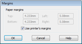

Paper margins - Top
ISldWorks::GetUserPreferenceDoubleValue(swUserPreferenceDoubleValue_e.swPageSetupPrinterTopMargin)
ISldWorks::SetUserPreferenceDoubleValue(swUserPreferenceDoubleValue_e.swPageSetupPrinterTopMargin, <Value>)
Double value in meters
Specifies width of left margin
Paper margins - Bottom
ISldWorks::GetUserPreferenceDoubleValue(swUserPreferenceDoubleValue_e.swPageSetupPrinterBottomMargin)
ISldWorks::SetUserPreferenceDoubleValue(swUserPreferenceDoubleValue_e.swPageSetupPrinterBottomMargin, <Value>)
Paper margins - Left
ISldWorks::GetUserPreferenceDoubleValue(swUserPreferenceDoubleValue_e.swPageSetupPrinterLeftMargin)
ISldWorks::SetUserPreferenceDoubleValue(swUserPreferenceDoubleValue_e.swPageSetupPrinterLeftMargin, <Value>)
Paper margins - Right
ISldWorks::GetUserPreferenceDoubleValue(swUserPreferenceDoubleValue_e.swPageSetupPrinterRightMargin)
ISldWorks::SetUserPreferenceDoubleValue(swUserPreferenceDoubleValue_e.swPageSetupPrinterRightMargin, <Value>)
Paper margins - Use printer's margins
ISldWorks::GetUserPreferenceToggle(swUserPreferenceToggle_e.swPageSetupPrinterUsePrinterMargin)
ISldWorks::SetUserPreferenceToggle(swUserPreferenceToggle_e.swPageSetupPrinterUsePrinterMargin, <OnFlag>)
Boolean value
Specifies whether to print document with printer's default margin values
