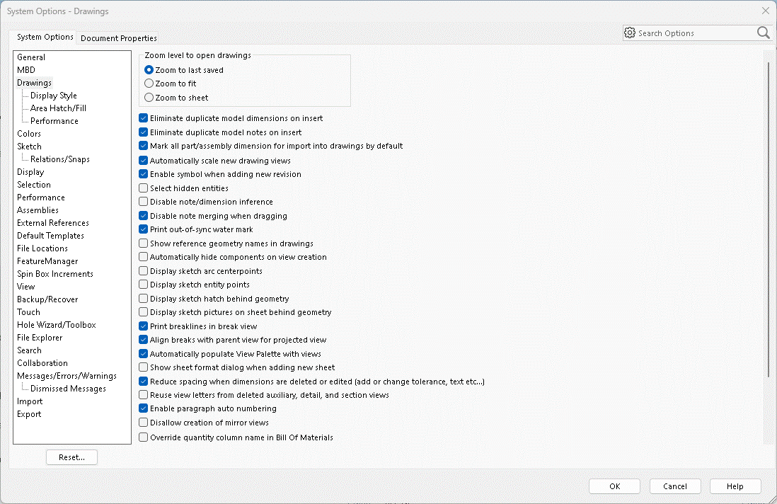

This topic contains two tables. The information in the table:
  • appearing immediately after the screen capture of the dialog corresponds to the settings on that dialog.
  • titled Obsolete Enumerators contains enumerators that previously appeared on the dialog but are now obsolete.
Setting
Get/Set Methods
Return Value
or
<Value>
or
<OnFlag>
Comment
Zoom level to open drawings
ISldWorks::GetUserPreferenceIntegerValue(swUserPreferenceIntegerValue_e.swZoomLevelOnOpen)
ISldWorks::SetUserPreferenceIntegerValue(swUserPreferenceIntegerValue_e.swZoomLevelOnOpen, swZoomLevelOnOpenType_e.<Value>)
See swZoomLevelOnOpenType_e for valid options
Eliminate duplicate model dimensions on insert
ISldWorks::GetUserPreferenceToggle(swUserPreferenceToggle_e.swDrawingEliminateDuplicateDimsOnInsert)
ISldWorks::SetUserPreferenceToggle(swUserPreferenceToggle_e.swDrawingEliminateDuplicateDimsOnInsert, <OnFlag>)
Boolean value
Specifies whether duplicate dimensions are eliminated when model dimensions inserted
Eliminate duplicate model notes on insert
ISldWorks::GetUserPreferenceToggle(swUserPreferenceToggle_e.swDrawingEliminateDuplicateModelNotesOnInsert)
ISldWorks::SetUserPreferenceToggle(swUserPreferenceToggle_e.swDrawingEliminateDuplicateModelNotesOnInsert, <OnFlag>)
Boolean value
Specifies whether to eliminate duplicate notes when model notes are inserted in a drawing
Mark all part/assembly dimension for import into drawings by default
ISldWorks::GetUserPreferenceToggle(swUserPreferenceToggle_e.swDrawingMarkAllDimensionsForDrawing)
ISldWorks::SetUserPreferenceToggle(swUserPreferenceToggle_e.swDrawingMarkAllDimensionsForDrawing, <OnFlag>)
Boolean value
Specifies whether to mark all part and assembly dimensions for import into drawings by default
Automatically scale new drawing views
ISldWorks::GetUserPreferenceToggle(swUserPreferenceToggle_e.swAutomaticScaling3ViewDrawings)
ISldWorks::SetUserPreferenceToggle(swUserPreferenceToggle_e.swAutomaticScaling3ViewDrawings, <OnFlag>)
Boolean value
Specifies whether new views are scaled to fit drawing sheet, regardless of selected paper size
Enable symbol when adding new revision
ISldWorks::GetUserPreferenceToggle(swUserPreferenceToggle_e.swDrawingEnableSymbolAddingNewRevision)
ISldWorks::SetUserPreferenceToggle(swUserPreferenceToggle_e.swDrawingEnableSymbolAddingNewRevision, <OnFlag>)
Boolean value
Specifies whether to insert revision symbols when a new revision row is added to a revision table
Display new detail circles as circles
ISldWorks::GetUserPreferenceToggle(swUserPreferenceToggle_e.swDrawingCreateDetailAsCircle)
ISldWorks::SetUserPreferenceToggle(swUserPreferenceToggle_e.swDrawingCreateDetailAsCircle, <OnFlag>)
Boolean value
Specifies whether new profiles for detail views are displayed as circles or sketched profiles
Select hidden entities
ISldWorks::GetUserPreferenceToggle(swUserPreferenceToggle_e.swDrawingSelectHiddenEntities)
ISldWorks::SetUserPreferenceToggle(swUserPreferenceToggle_e.swDrawingSelectHiddenEntities, <OnFlag>)
Boolean value
Specifies whether hidden tangent edges and edges hidden manually can be selected
Disable note/dimension inference
ISldWorks::GetUserPreferenceToggle(swUserPreferenceToggle_e.swDrawingDisableNoteDimensionInference)
ISldWorks::SetUserPreferenceToggle(swUserPreferenceToggle_e.swDrawingDisableNoteDimensionInference, <OnFlag>)
Boolean value
Specifies whether to disable note and dimension inferencing in drawings
Disable note merging when dragging
ISldWorks::GetUserPreferenceToggle(swUserPreferenceToggle_e.swDrawingDisableNoteMergeWhenDragging)
ISldWorks::SetUserPreferenceToggle(swUserPreferenceToggle_e.swDrawingDisableNoteMergeWhenDragging, <OnFlag>)
Boolean
Specifies whether to merge two notes, or a note and a dimension, when dragged toward each other
Print out-of-sync water mark
ISldWorks::GetUserPreferenceToggle(swUserPreferenceToggle_e.swRapidDraftPrintOutOfSynchWaterMark)
ISldWorks::SetUserPreferenceToggle(swUserPreferenceToggle_e.swRapidDraftPrintOutOfSynchWaterMark, <OnFlag>)
Boolean value
Specifies whether to print out-of-synch watermarks on detached drawings printouts if drawings not synchronized with the models
Show reference geometry names in drawings
ISldWorks::GetUserPreferenceToggle(swUserPreferenceToggle_e.swShowRefGeomName)
ISldWorks::SetUserPreferenceToggle(swUserPreferenceToggle_e.swShowRefGeomName, <OnFlag>)
Boolean value
Specifies whether to show names of reference geometry entities when imported into a drawing
Automatically hide components on view creation
ISldWorks::GetUserPreferenceToggle(swUserPreferenceToggle_e.swDrawingViewAutoHideComponents)
ISldWorks::SetUserPreferenceToggle(swUserPreferenceToggle_e.swDrawingViewAutoHideComponents, <OnFlag>)
Boolean value
Specifies whether any components of assembly not visible in a new drawing view are hidden
Display sketch arc centerpoints
ISldWorks::GetUserPreferenceToggle(swUserPreferenceToggle_e.swDrawingDisplayArcCenterPoints)
ISldWorks::SetUserPreferenceToggle(swUserPreferenceToggle_e.swDrawingDisplayArcCenterPoints, <OnFlag>)
Boolean value
Specifies whether to display arc center points
Display sketch entity points
ISldWorks::GetUserPreferenceToggle(swUserPreferenceToggle_e.swDrawingDisplayEntityPoints)
ISldWorks::SetUserPreferenceToggle(swUserPreferenceToggle_e.swDrawingDisplayEntityPoints, <OnFlag>)
Boolean value
Specifies whether to display sketch entity points
Display sketch hatch behind geometry
ISldWorks::GetUserPreferenceToggle(swUserPreferenceToggle_e.swDrawingDisplaySketchHatchBehindGeometry)
ISldWorks::SetUserPreferenceToggle(swUserPreferenceToggle_e.swDrawingDisplaySketchHatchBehindGeometry, <OnFlag>)
Boolean value
Specifies whether to display sketch hatch behind geometry
Display sketch pictures on sheet behind geometry
ISldWorks::GetUserPreferenceToggle(swUserPreferenceToggle_e.swDrawingDisplaySketchPicturesOnSheetBehindGeometry)
ISldWorks::SetUserPreferenceToggle(swUserPreferenceToggle_e.swDrawingDisplaySketchPicturesOnSheetBehindGeometry, <OnFlag>)
Boolean value
Specifies whether to display sketch pictures behind geometry
Print breaklines in break view
ISldWorks::GetUserPreferenceToggle(swUserPreferenceToggle_e.swDrawingPrintBreaklinesInBrokenView)
ISldWorks::SetUserPreferenceToggle(swUserPreferenceToggle_e.swDrawingPrintBreaklinesInBrokenView, <OnFlag>)
Boolean value
Specifies whether to print breaklines in break views
Align breaks with parent view for projected view
ISldWorks::GetUserPreferenceToggle(swUserPreferenceToggle_e.swBreakAlignWithParent
ISldWorks::SetUserPreferenceToggle(swUserPreferenceToggle_e.swBreakAlignWithParent, <OnFlag>)
Boolean value
Specifies whether to align break lines of a projected view with its parent view; by default, set to true
Automatically populate View Palette with views
ISldWorks::GetUserPreferenceToggle(swUserPreferenceToggle_e.swShowDrawingViewPalette)
ISldWorks::SetUserPreferenceToggle(swUserPreferenceToggle_e.swShowDrawingViewPalette, <OnFlag>)
Boolean value
Specifies whether to show View Palette
Show sheet format dialog when adding new sheet
ISldWorks::GetUserPreferenceToggle(swUserPreferenceToggle_e.swDrawingShowSheetFormatDialog)
ISldWorks::SetUserPreferenceToggle(swUserPreferenceToggle_e.swDrawingShowSheetFormatDialog, <OnFlag>)
Boolean value
Specifies whether to show the drawing sheet format dialog when adding new drawing sheets
Reduce spacing when dimensions are deleted or edited (add or change tolerance, text etc...)
ISldWorks::GetUserPreferenceToggle(swUserPreferenceToggle_e.swDrawingAutoSpaceDimsOnDelete)
ISldWorks::SetUserPreferenceToggle(swUserPreferenceToggle_e.swDrawingAutoSpaceDimsOnDelete, <OnFlag>)
Boolean value
Specifies whether to adjust spacing when dimensions are deleted or text is removed
Reuse view letters from deleted auxiliary, detail, and section views
ISldWorks::GetUserPreferenceToggle(swUserPreferenceToggle_e.swDrawingReuseViewLettersFromDeletedAuxilary)
ISldWorks::SetUserPreferenceToggle(swUserPreferenceToggle_e.swDrawingReuseViewLettersFromDeletedAuxilary, <OnFlag>)
Boolean value
Specifies whether to reuse letters from deleted views (auxiliary, detail, and section) in the drawing
Enable paragraph auto numbering
ISldWorks::GetUserPreferenceToggle(swUserPreferenceToggle_e.swNoteParagraphAutoNumbering)
ISldWorks::SetUserPreferenceToggle(swUserPreferenceToggle_e.swNoteParagraphAutoNumbering, <OnFlag>)
Boolean value
Specifies whether to enable Microsoft Word-like auto-numbering behavior in notes; enabled by default
Zoom to fit on open
ISldWorks::GetUserPreferenceToggle(swUserPreferenceToggle_e.swNoteZoomToFit)
ISldWorks::SetUserPreferenceToggle(swUserPreferenceToggle_e.swNoteZoomToFit, <OnFlag>)
Boolean value
Zoom to fit on open
Override quantity column name in Bill Of Materials
ISldWorks::GetUserPreferenceToggle(swUserPreferenceToggle_e.swOverrideQuantityColumnName)
ISldWorks::SetUserPreferenceToggle(swUserPreferenceToggle_e.swOverrideQuantityColumnName, <OnFlag>)
Boolean value
Specifies whether to override the quantity column name in Bill of Materials
Name to use
ISldWorks::GetUserPreferenceStringValue(swUserPreferenceStringValue_e.swOverriddenQuantityColumnName)
ISldWorks::SetUserPreferenceStringValue(swUserPreferenceStringValue_e.swOverriddenQuantityColumnName, <Value>)
String value
String for quantity column name in Bill of Materials
Detail view scaling
ISldWorks::GetUserPreferenceDoubleValue(swUserPreferenceDoubleValue_e.swDrawingDetailViewScale)
ISldWorks::SetUserPreferenceDoubleValue(swUserPreferenceDoubleValue_e.swDrawingDetailViewScale, <Value>)
Double value
Specifies value to scale detail views
Custom property used as Revision
ISldWorks::GetUserPreferenceStringValue(swUserPreferenceStringValue_e.swDrawingCustomPropertyUsedAsRevision)
ISldWorks::SetUserPreferenceStringValue(swUserPreferenceStringValue_e.swDrawingCustomPropertyUsedAsRevision, <Value>)
String value
Specifies custom property for drawing revision
Keyboard movement increment
ISldWorks::GetUserPreferenceDoubleValue(swUserPreferenceDoubleValue_e.swDrawingKeyboardMovementIncrement)
ISldWorks::SetUserPreferenceDoubleValue(swUserPreferenceDoubleValue_e.wDrawingKeyboardMovementIncrement, <Value>)
Double value
Specifies the unit value of movement when you use the arrow keys to move (nudge) drawing views, annotations, or dimensions
