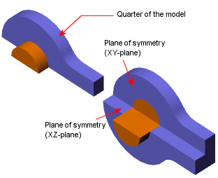

The eyebar assembly is loaded and supported as shown.
Due to double symmetry, you analyze one quarter of the model.
