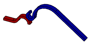

Large Displacement Contact
Contact problems assume small displacements by default. This lesson demonstrates that this assumption can cause convergence to a wrong solution when the actual displacements are large. Using the large displacement function causes convergence to the correct solution.
In this lesson, you learn the following:
  • Applying prescribed displacement
  • Defining local contact with friction
  • Running the contact problem and assessing contact results
  • Activating large displacement contact and rerunning the problem
