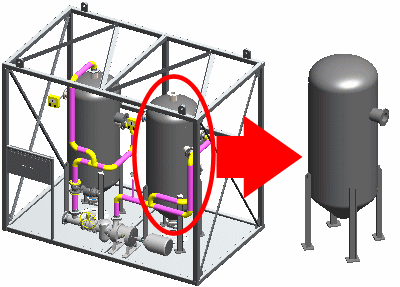

The assembly below shows a pressure vessel skid commonly used in the petrochemical industry. In this lesson, you analyze one of the tanks that is subjected to internal pressure, temperature rise, and earthquake loads simulated by gravitational loads.
