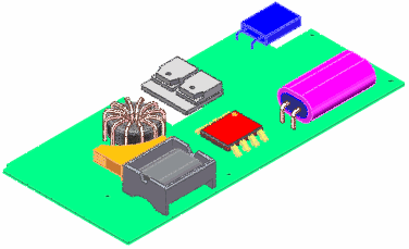

You evaluate the response of a circuit board to a random vibration environment. The circuit board is subjected to an acceleration PSD (Power Spectral Density) profile recommended by NASA (National Aeronautics and Space Administration) to test hardware for flight qualification.
